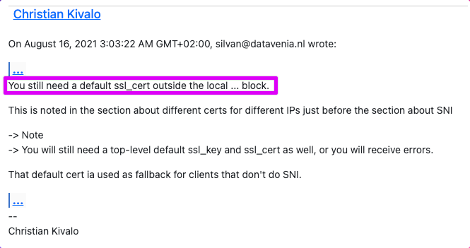

After another 5 hours I found the culprit thanks to this post, and specifically this sentence (hats of to Christian Kivalo !):

My gut feeling is the 10-ssl.conf file was broken by following bad advice. What made this complicated to solve on a busy server, is for each ssl_cert setting we had 4 x 220, and we kept on looking and working in the wrong place.

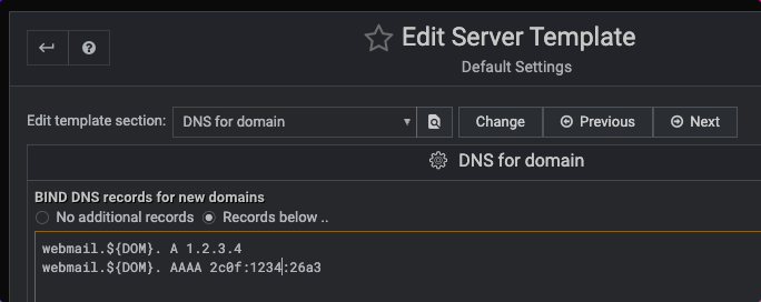

  • Create a template that will still create a webmail.* record after each domain creation
Then you just create an alias as usual on an anchor domain, WITHOUT DNS to avoid clutter.
I love Virtualmin and my as a tech loves Usermin and it’s power too, but for my typical end-user I can’t give two tools and most prefer Roundcube.
Maybe as a start, on the Edit Server Template → Website for domain, instead of just “Redirect webmail.${DOM} Yes/No”, another option,
“Still create webmail.${DOM} DNS record when creating server.”
One less step to easily configure Roundcube for all :slightly_smiling_face:

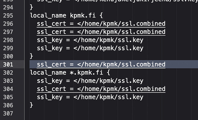

I’ve been doing some migration from server to server using the built-in backup & restore -functions and this is really getting frustrating :frowning:
I’ve narrowed it down, that if I choose to restore SSL sertificates, it pretty much always corrupts the dovecot.conf file:
Highlighted row is the one that’s causing the whole dovecot going haywire and SSL-connections to IMAP etc starts to fail. Every time I restore server, I have triple check the whole dovecot.conf and fix it manually & restart the service.
It also usually corrupts if I restore top level server with it’s sub servers at the same run. Usually restoring just single top level servers works 9/10 times.

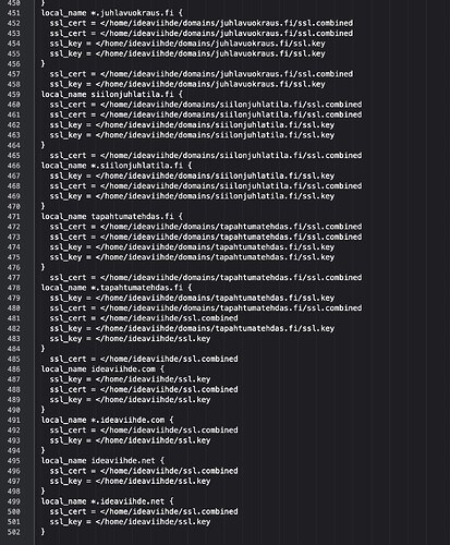

Here is an example of my dovecot.conf after restoring parent server with some sub servers, as you can see, it’s a total mess :smiley:
