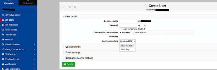

I am logged in as the admin of the account with no FTP and no SSH for the admin, only Database and email:
I don’t have a drop down option to change login.

When I am logged in as admin with full privileges i see this:

As root or sudo user to the server, change the admin account for the virtualserver to only have email access and it will remove the drop down option to allow others access to ssh and ftp.
