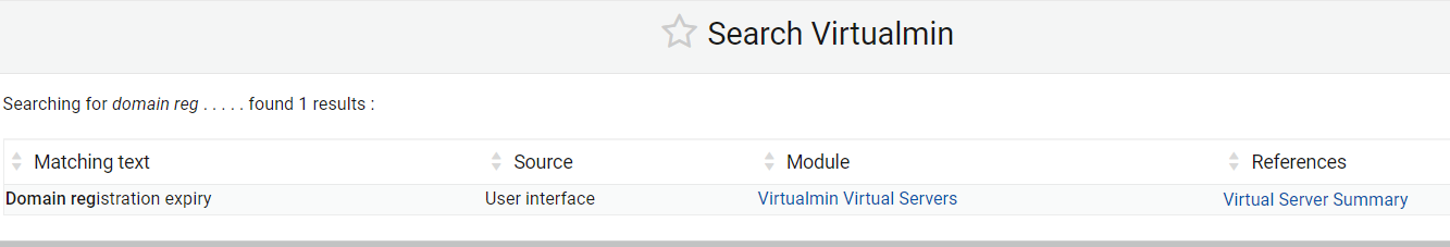

in vm search type ‘domain reg’ and click the link. You will see

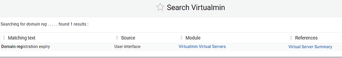

Nope
You dont have pro then i guess
Ah! that would be why. Not a problem, thanks I was just curious (the registrars used are far and wide and not something I direct clients on (they spend their $$ wherever they want to) CloudFlare just seems to be like adding another layer of complexity for seemingly little gain for me.
