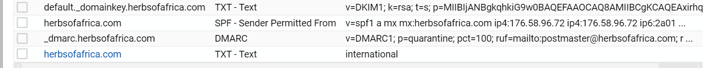

I am trying to update my DNS records using TXT type records.
I have actually configured DKIM, DMARC and SPF records, using the virtualmin interfaces. All of these mentioned records are showing to be ABSENT when I lookup my DNS records with tools like DNS Checker - DNS Check Propagation Tool
I also tried to update the DNS records with just a TXT record of my own.
I can see the TXT record in the list of DNS records showing on Virtualmin, but its been 3days now, I still can’t find any of these records on dns checker or any other dns tools out there.
Please assist
Please read my last PM messages. You need to copy these entries from Virtualmin and enter them into Linode where your DNS is being handled…

Your Virtualmin server is not your DNS server. Propagation has nothing to do with it. If you want Virtualmin to manage your DNS locally on the server, you need to delegate authority for your zone at your registrar with appropriate glue records.
If you are not managing DNS locally, you should disable the DNS Feature in Virtualmin so Virtualmin instead offers you a “Suggested Records” page you can copy/paste from instead of trying to manage them directly. You shouldn’t let Virtualmin believe it is responsible for DNS if it isn’t.
