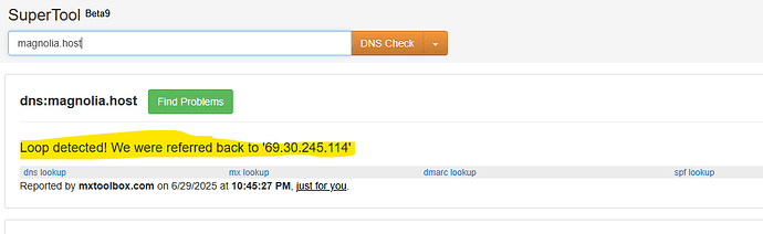

I get a weird error I’ve never seen before at mxtools. It maybe registrary settings or nameservers not setup correctly.
For magnolia.host have you created the NS records ie magnolia.host. NS ns1.nullusanxietas.com
