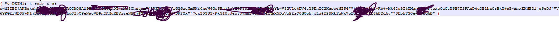

Here is the picture I got from GMAIL header
That suggest to me that it is Google/GMail failing to recognise your email server rather than a Virtualmin failure. I think that may have been covered on here somewhere [a search](https://forum.virtualmin.com/search?expanded=true). did Virtualmin complain when you set it up?
Yes you are right. It is from Gmail.
Please what can I do?

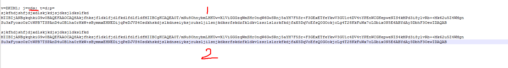

OK. Let me show you what is there.
you used the correct format? VM uses the year its created.
Yeah, my key is 2023+month it was created
The picture is just same and I want to know if the first or the second one is the right format to create TXT record on my domain registrar side.
Neither look right, you create the txt record from what is shown.
so what do you have here.
and the text record is shown
It can be a pain as you take what between the beginning and end quote including the quote, but remove the middle quotes so its all one thing.

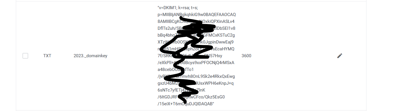

this from my DNS

This is my DKIN record as pasted in my domain registrar DNS record using TXT type . Yet nothing works
Who run the DNS, is it run by you or a provider? The format can be different.
I copied everything i saw in virtualmin DNS record into my domain registrar NAMECHEAP.
Remove the Brackets, start at "v=DKIM1; k=rsa; p=
then remove any quotes in the middle section
So DJ""V should be DJV. Check the screen shot of my DNS, no brackets and no “” in the middle section.
