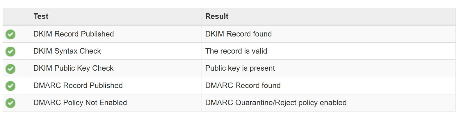

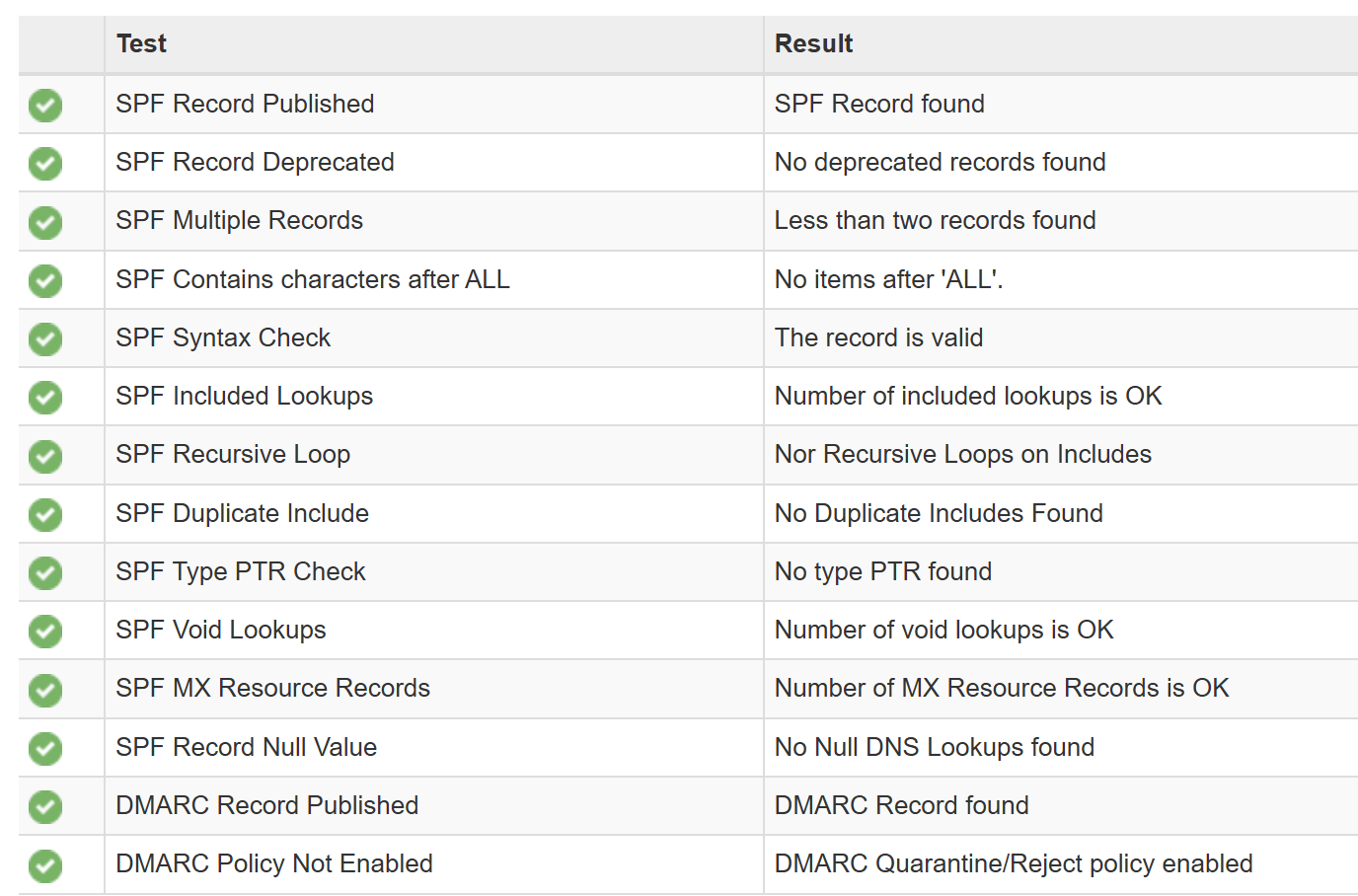

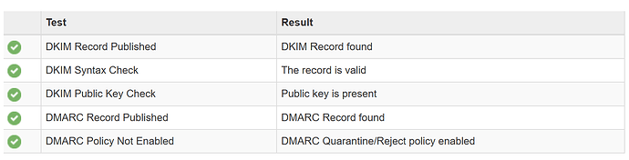

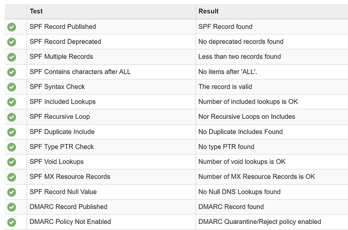

I use an external registry and DNS

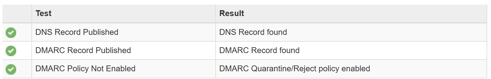

all records are correct, and mxtoolbox says SPF, DMRAC, DKIM are correct
but no outbound emails are signed.

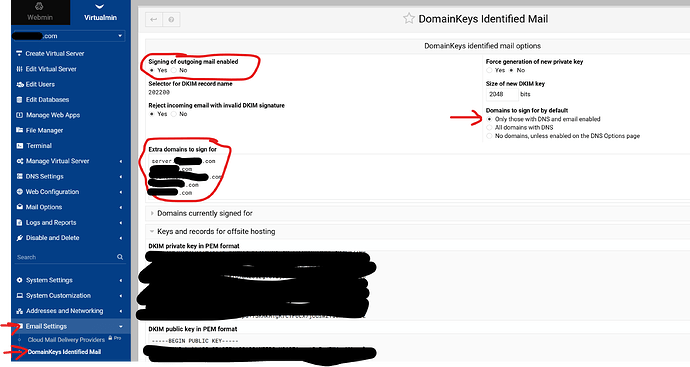

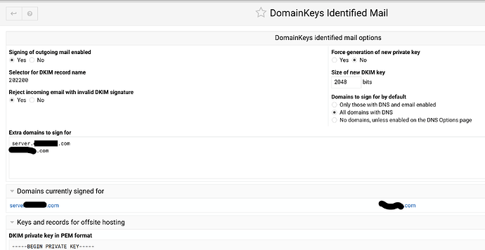

in /etc/dkim-domains.txt i have:
server.domain.com
domain.com
then in opendkim.conf, i have
Domain /etc/dkim-domains.txt
Selector 202200
KeyFile /etc/dkim.key
which matches the key file, and hence mxtoolbox says its all good.
then hit save:
"Finding virtual servers to enable DKIM for ..
.. no virtual servers with DNS and email enabled were found, but enabling for 2 extra domains
Extracting public key from private key in /etc/dkim.key ..
.. done
Setting domain and selector in DKIM filter configuration ..
.. done
Enabling DKIM filter at boot time ..
.. done
Starting DKIM filter ..
.. done
Configuring mail server to use DKIM filter ..

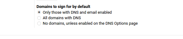

.. done
ideas? the setting doesnt make sense as external DNS, but still says “but enabling for 2 extra domains”
but no external signature, as verified with https://dkimvalidator.com/

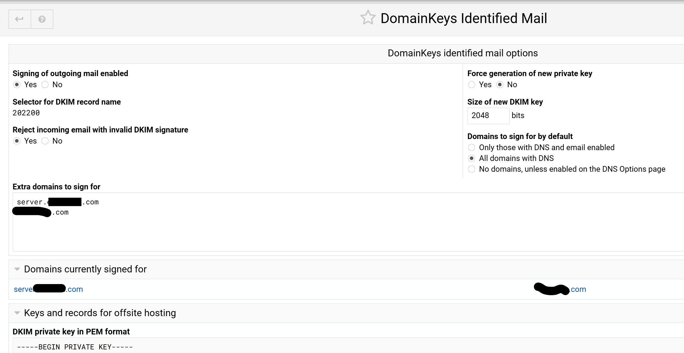

I have had no issue, try

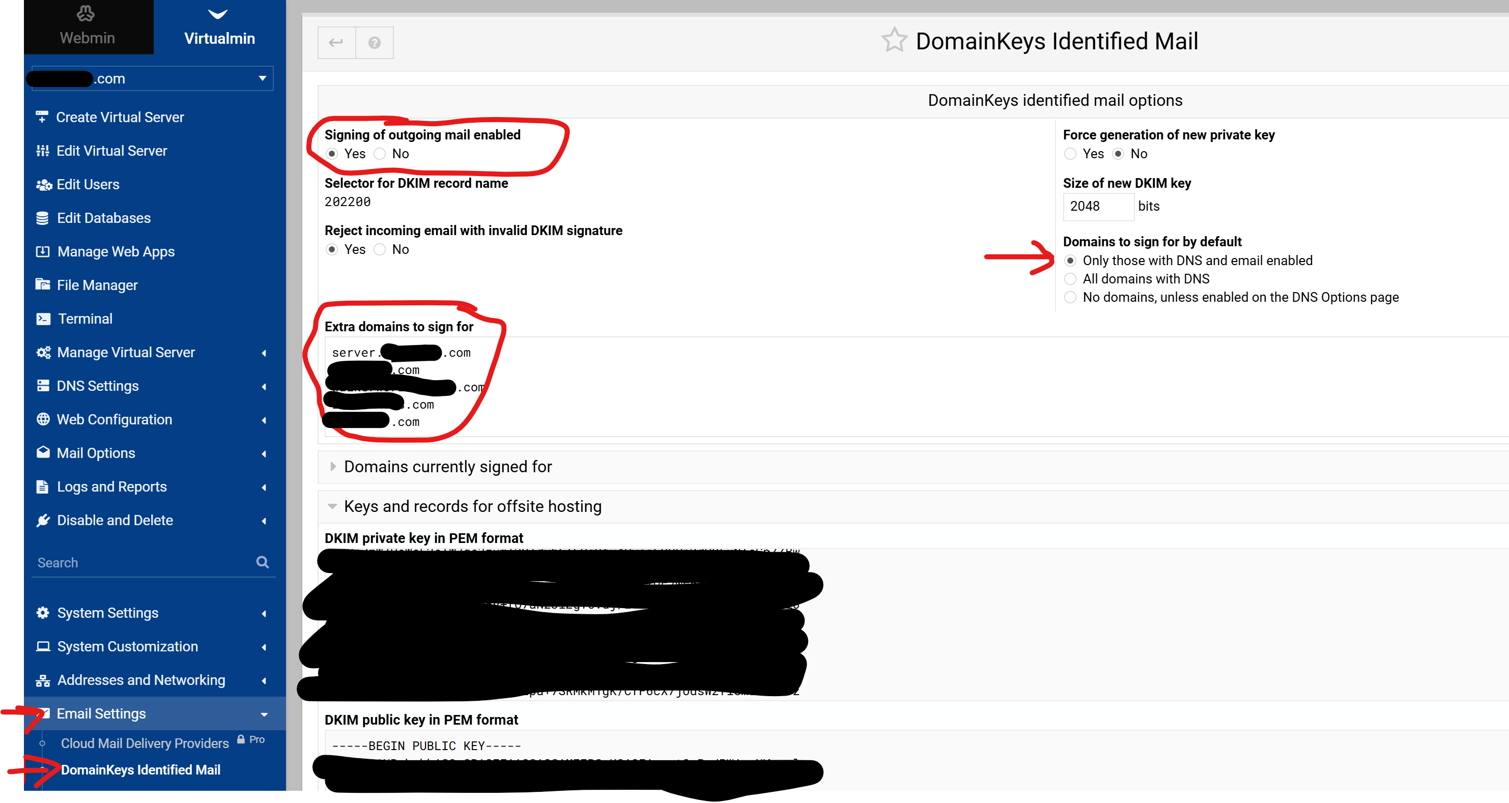

tried them both, no difference. They used to work, maybe an update over the last year changed things. are we certain that an external Registra / DNS config, not using Webmin / Virtualmin BIND at all - will DKIM still work ?
Oh WOW. I just got it to work. I disabled DKIM, then re-enabled it, and this fixed ! must have been an update, like others have mentioned, over time the domains dissappeared in the “Extra domains to sign for”, and re-entering the domains by themselves does not work, you have to disable, then re-enable wqith “Signing of outgoing mail enabled”
