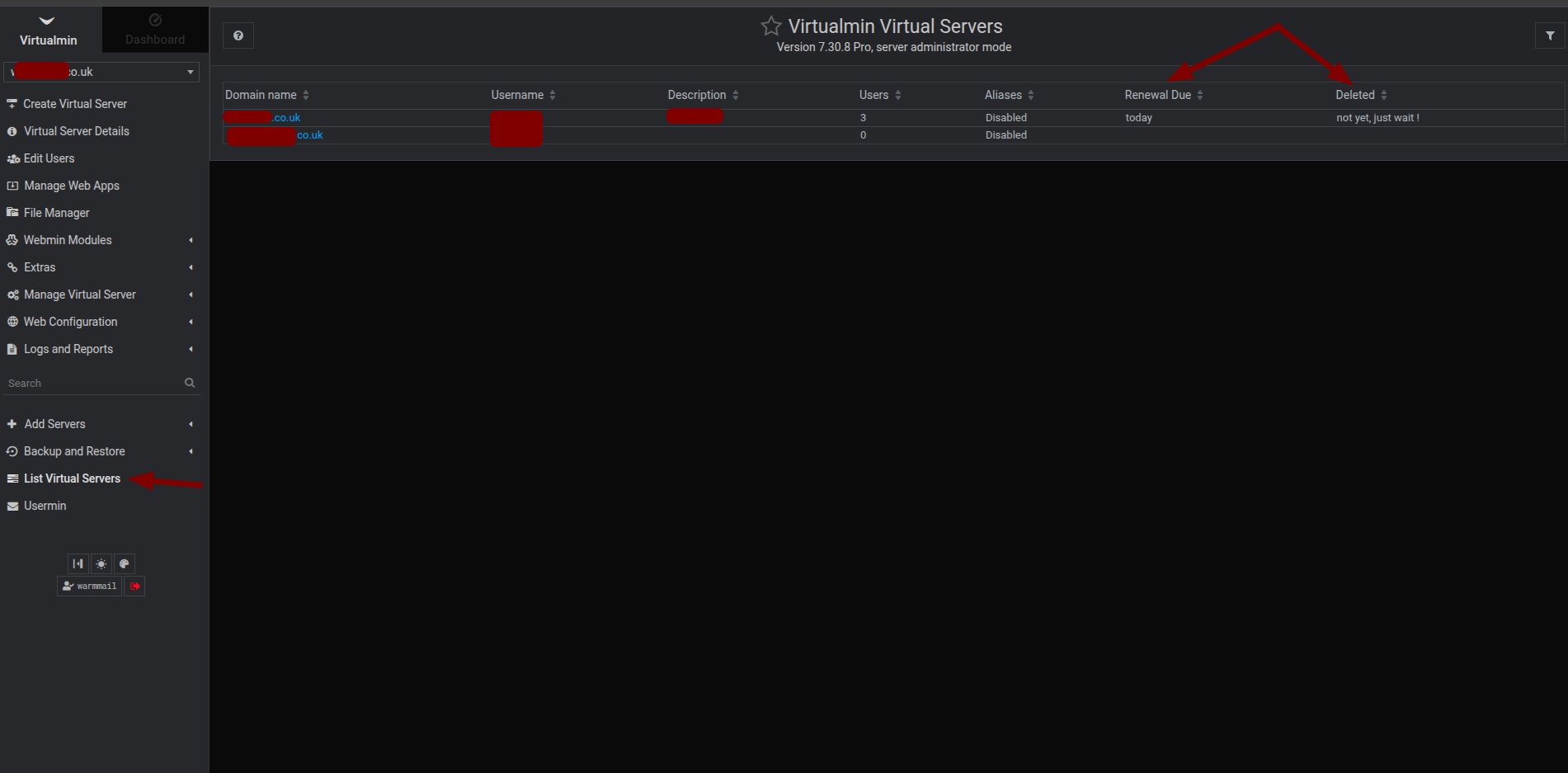

I don’t think the theme does it, but it may, just set the initial page to “List Virtual Servers” and the user(s) will default to that page

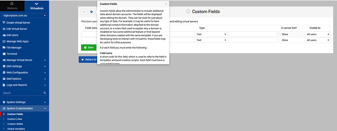

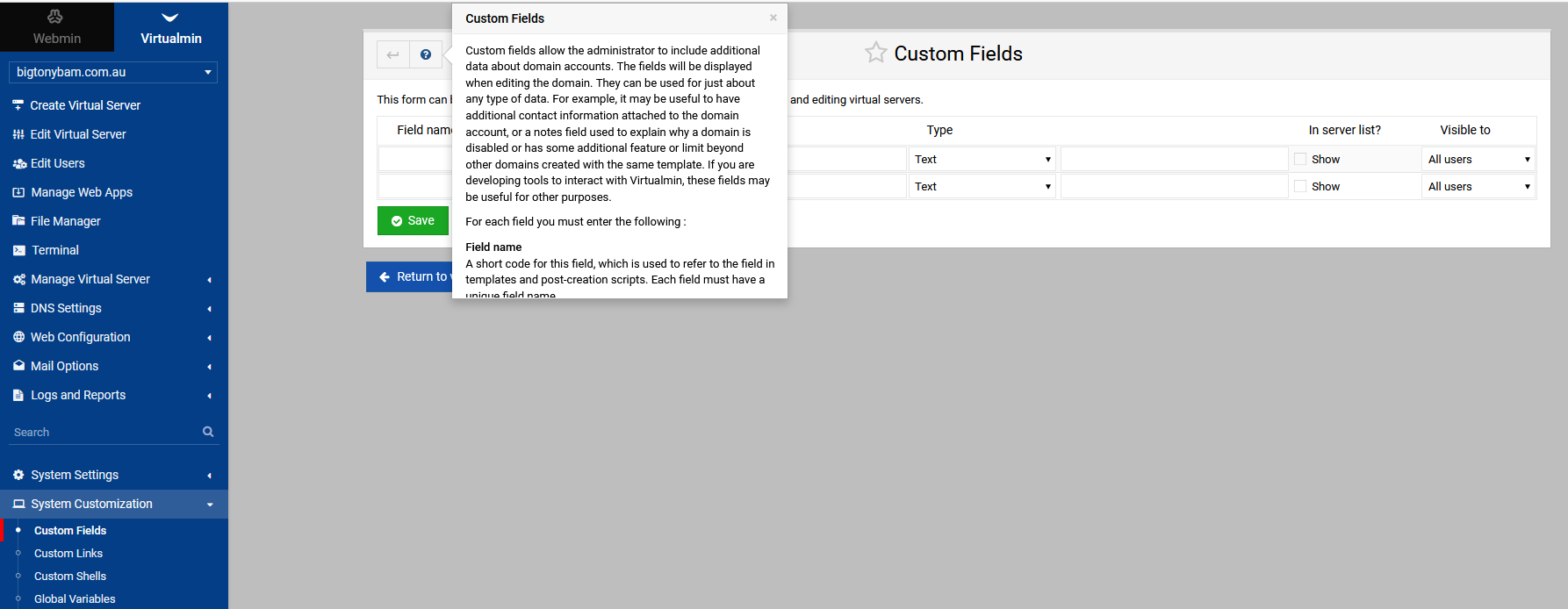

yeah exactly but how did you add these extra fields in Virtualmin ?
Simple just add some custom fields to the virtualmin settings then add the required text to the custom fields per domain. I’m sure there is away of automating this via the virtualmin api, but this may be a pro feature

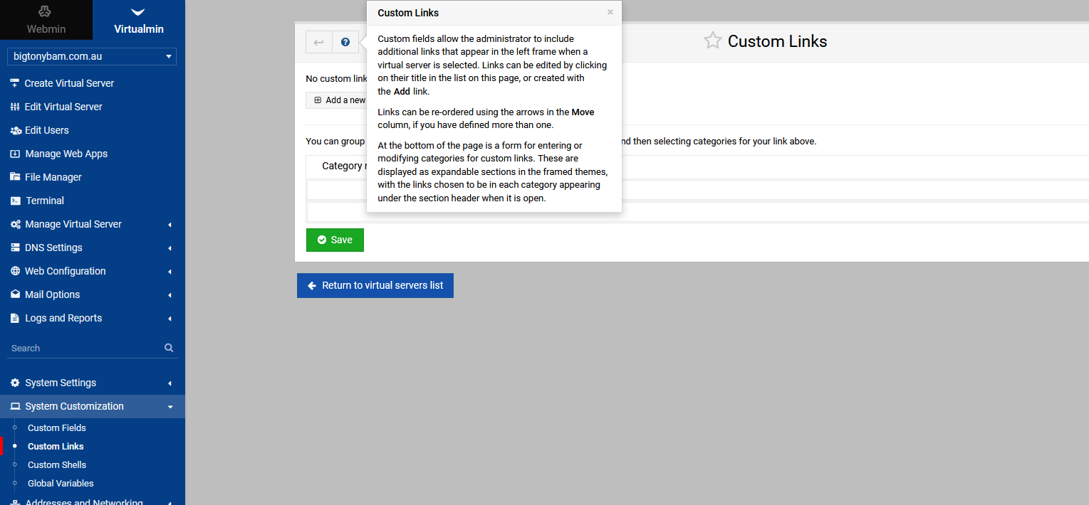

I think custom fields is standand but custom links is pro.
