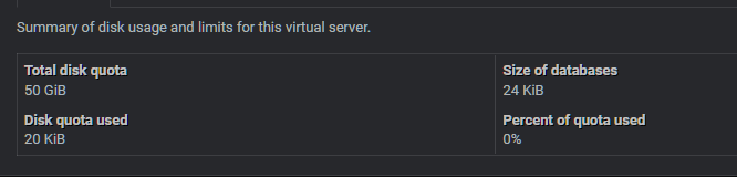

Hi. I have one server whose files are not stored on the main disk of the server. Instead its on an attached volume. I’m using Linode here.
The volume is mounted on /home/storage1/ and virtualmin stored the server’s files correctly in /home/storage1/domainname/...
The problem is that it doesn’t measure the disk quotas for this server. I don’t see its entry on the Dashboard in the “Disk Quota” card. It also doesn’t detect any usage in Logs & Reports > Disk Usage. This server is actually occupying around 13GB of space.

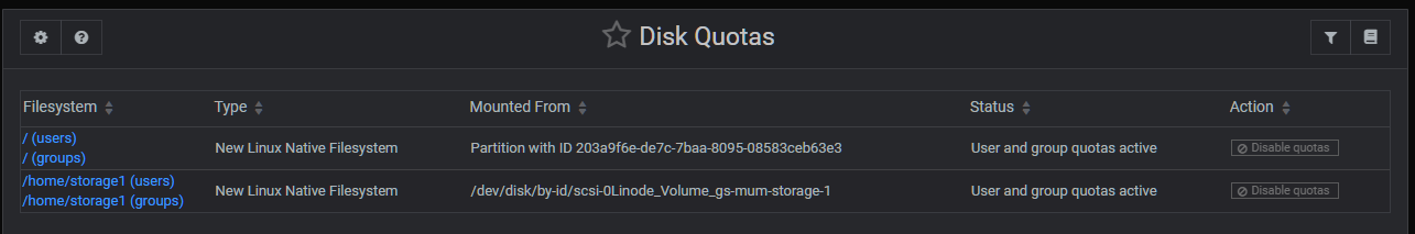

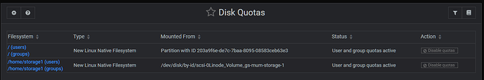

I did enable the disk quota in webmin

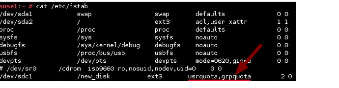

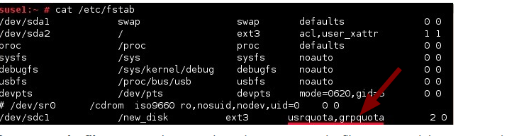

this may help you enable quotas on your mounted disk
looking at this bit in particular
Thanks for taking the time. I already have that in my fstab file. Here’s the complete contents of /etc/fstab file
UUID=203a9f6e-de7c-7baa-8095-08583ceb63e3       /       ext4    relatime,quota,grpquota,usrquota,rw,errors=remount-ro   0       1
UUID=f1408ea6-59a0-11ed-bc9d-525400000001  none  swap  sw                 0  0
/dev/disk/by-id/scsi-0Linode_Volume_gs-mum-storage-1    /home/storage1  ext4    noatime,nofail,usrquota,grpquota        0       2
Its safe to post this, right?
