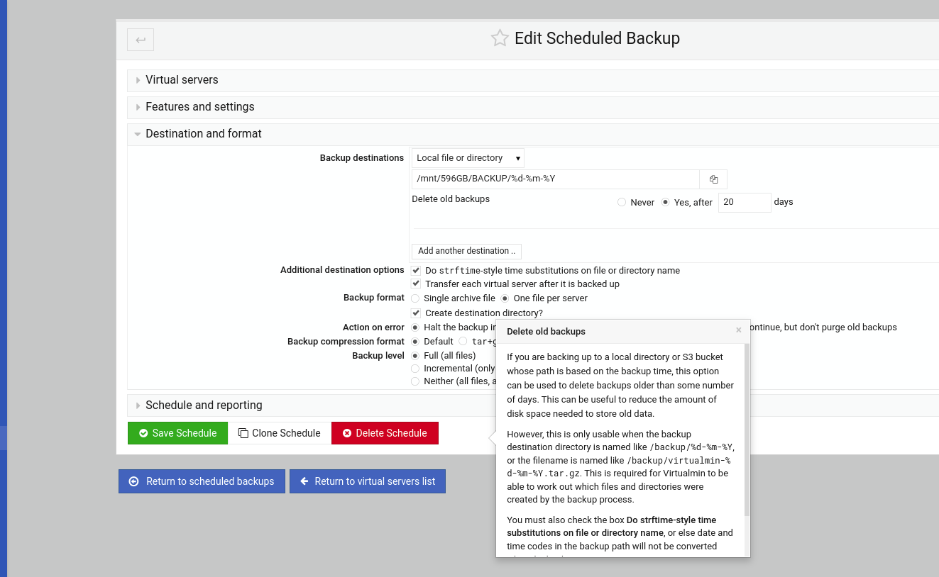

Hello, i have a server with virtualmin (only hosting 1 website) and i must backup on remote ssh server.
i setup backup like picture, works fine but on remote server i find
2022-02-07–00-00 folder (with date 2022/02/07 - 01:57:49)
why virtualmin don’t delete this old backup?
thank you

Edit, I do backup everything to local hdd (spinning one) and every time backup finishes I do ssh to another machine with rsync which sync that hdd to another server outside (its all automated via bash scripts… after initial point of backup from virtualmin gui) - that server then sync back to my home server located in my home country… so I have multiple locations of this just in case fire or whatever happens… I hope so you can read that popup on screenshot… you can enlarge image by click it on it.

@ale.ab the screenshot is saying it all… you use strftime within the backups… do you know how this works in linux at all?
