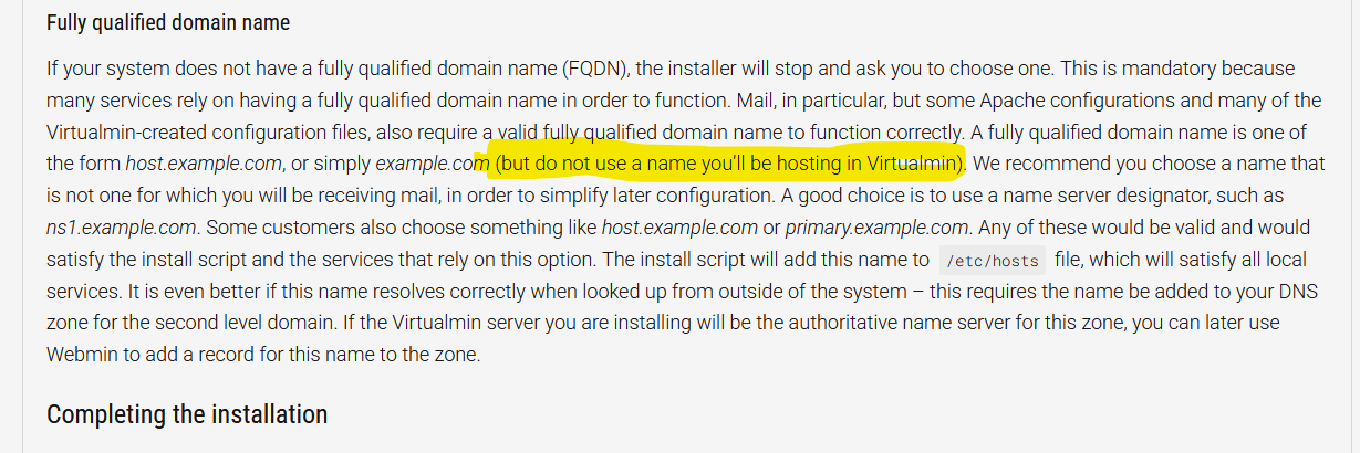

You should not do that. That is expected behavior so a ssl can be issued during installation.
As noted in many places in the documentation, you should not do that.
If you’re hosting email for that domain in Virtualmin, you need to change the system hostname. It’s just asking for trouble to try to virtually host something that is also the system name.
You can disable the hostname-based virtual server, but that doesn’t solve the problem of trying to make a single domain name be two things.
This topic has been here before. The creation of the default_hostname is an expected behavior implementet by the devs when you toggle the checkbox
Setup SSL certificate from provider for hostname
in
VirtualminSystem SettingsVirtualmin ConfigurationSSL settings
