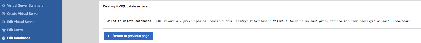

Deleting an assigned database without error message after it had been moved is also not working
after you have moved a server to the main server position.
It deleted the database but the message is pretty confusing!
Even databases are assigned they can’t get deleted when the server gets deleted

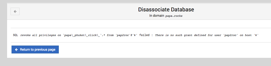

`Delete Server
In domain bec2one
Deleting mail aliases …
… done
Deleting MySQL database bec2one …
… MySQL database failed! : mysql::execute_sql_logged failed : SQL revoke all privileges on bec2one.* from ‘bec2one’@’%’ failed : There is no such grant defined for user ‘bec2one’ on host ‘%’ at /usr/share/webmin/web-lib-funcs.pl line 1496.

We don’t support yet MariaDB 10.4+. Sorry. It’s a lot of work to switch to using new ALTER statement.
is also not working - it seems there is much more which needs to be changed
Here is another conflict - keep it for the record so it can be fixed - As more and more people are using MariaDB it would really be recommended to integrate and give much more love to MariaDB and keeping things running with updated versions is also more and more common since we have stuff in clouds.
MariaDB is supported. Ilia said MariaDB version 10.4+. The version is the problem.
That is what I understood Joe but we simply can’t improving only because a version has a new feature or a new alter syntax.
The point is that new customers want to start with new hardware and with new software and not on software which is already 2 years old from its last release date, so somehow we need to keep up to date also to avoid problems which were existing before PHP 5.2 - you might remember. Hosters did not upgrade! - Times have changed and especially in the cloud you do good to keep your stuff updated.
10.4 is the stable release and 10.5 has already its release candidate and coming soon (Probably in mid June) with further speed improvements.
I know that ALTER changed in 10.4 but that is the case already since 26 June 2019.
