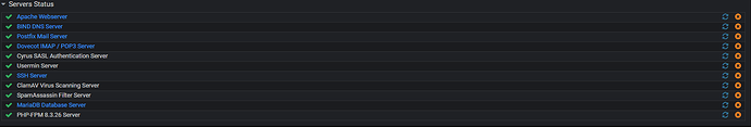

New Rocky Linux Install
Installed OS Postgresql
Installed webmin-postgresql
Strated Postgresql server and configured
Postgresql does not dhow in Dashboard server status, MariaDB does
Is there a config I’m missing?

What I’m asking is why does not postgres server show in Dashboard under Server Status:
Or is this expected new results?
I just installed Virvualmin 8 new so maybe I’m missing new documentation?

So wait, Postgres is not mentioned anywhere on the verbose breakdown? And you did visit the module in Webmin and can see it listed as running? Additionally, when you ran the Install Wizard, is Postgres selected as enabled? ( Webmin → System Settings → Re-Run Install Wizard )

I see the postgres server now
Must have been something with SELinux

To make it show, after you’ve manually installed the PostgreSQL package and the Webmin PostgreSQL module, you also need to run (as explained in our docs ):
virtualmin-config-system -i PostgreSQL
And, then go to “System Settings ⇾ Features and Plugins” page and enabled PostgreSQL database feature.
