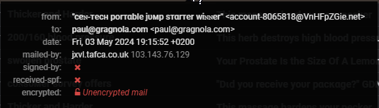

I also seem to have some messages that are not going through the SA filter (as they are getting no SA score), like this,

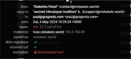

Whereas, I’d normally get the spam score as below,

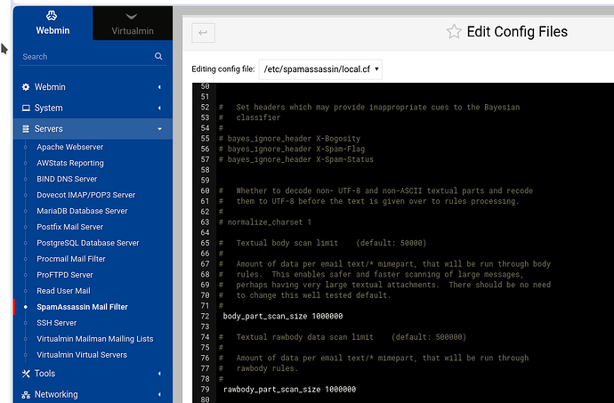

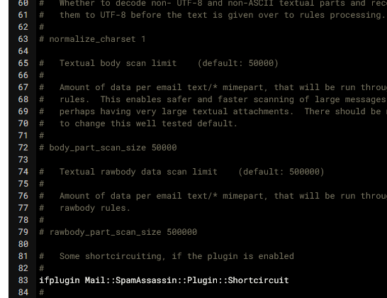

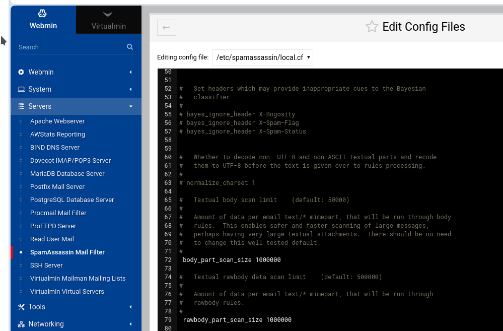

I’ve mentioned this before. Default SA doesn’t process emails over 512K so spammers pad the email. I set mine to 1M and that seemed to stop that problem.
@ID10T I have added this to my notes from one of your earlier threads. Very useful. alot of emails are above 512KB, even the spammy ones.
Yes, I noticed on my old cPanel server a bunch of spam had started to come in at 2Mb.

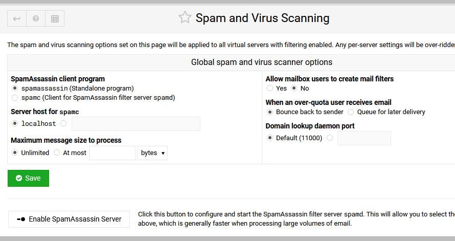

@ID10T can you give me the location of where you change this setting because this is my page
Virtualmin --> System settings --> Spam and Virus Scanning --> Maximum message size to process: unlimited
p.s. I know spamassain is not running , this is my dev site
looks like this might of changed at some point.
It solved my issue. Is this the right place to do it? I don’t know. I should probably have looked harder, but… :wink:
this was a valid solution as not everyone’s virtualmin will be setup like mine. I also did not know it had been changed and I also have not check to see if the unlimited value actually works as I have not actually used mail properly on my server yet.
Thats the correct place to change it

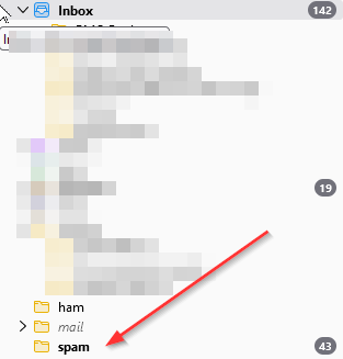

Virtualmin has a spamassassin setting for each user to create a spam folder and auto dump spam into that folder:

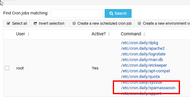

In /etc/cron.daily folder is spamassassin.sh which runs nightly and updates spamassassin. my cron is:
To process the spam after 10 days I run this cron job (taken from another internet post). There are versions of this script to run all users but this is one user only:
the first job deletes spam mail after 10 days.
2nd and 3rd jobs learn spam from your spam folder (read and unread folders) for that user.
4th job learns “ham” mail (non spam) from an optional ham folder. I use that to help learn what is non-spam.

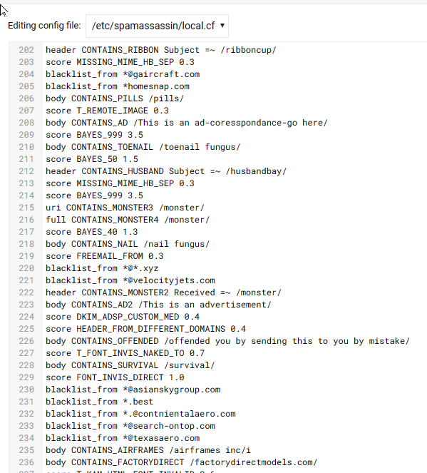

One of the best tools is the spamassassin/local.cf file with all the weights and expressions to determine the weight of spam triggers. You can update the config on virtualmin but I learned to update my own rules directly in the file and I added regex checks for specific problems I was having. For example, I can check subjects for having three words in any order because the sender kept mixing them up and it was not caught quickly enough. This would not be typical but I was trying to learn something.
header CONTAINS_MUTUAL1 Return-path =~ /(?=.*mutual)(?=.*mortgage)(?=.*omaha)/i
The config file is large but if you have persistent problems you can add the test and some weights and it will clean up your inbox quickly. You can apply globally to all users or each user independently. All of my info comes from searches for SA scripts and help.
