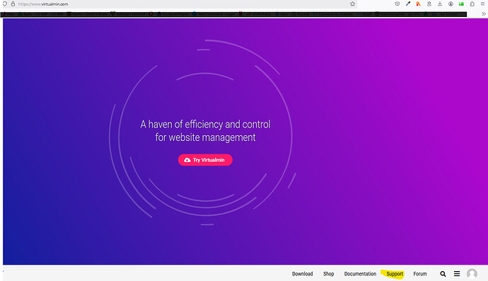

Did you file a bug? This is the first time I’ve heard of such a problem.
We release updates every few weeks, usually with a combination of bugfixes and new features, as we have consistently done for two decades. I don’t know how you could come to the conclusion that we don’t fix bugs. But, we can’t fix bugs we don’t know about.
I came to that conclusion by these 3 items
  1. I couldn’t see any place on your site to report bugs. I’ve since taken a closer look and found the link to an external site tucked away at the bottom of the support page. Ok fine I’ll head there after this.
  2. The disinterest you showed in the reported bug in the first paragraph of my original post vs. quibbling about the merits of html vs markdown.
  3. The fact I haven’t had a single technical question posted to this forum answered whether it’s hooking into your procmail process or your user creation process. I get that paying customers have priority but I’m literally trying to add features that will benefit your entire user base. It seems like you have the time to post a new novel to the forum about how undermanned and underfunded virtualmin is every day but not 30 seconds to help me help you.
Where would you expect to find information about filing bugs, if not the Support page? (I am asking a genuine question. I don’t know where else we should put it to make it something one would find when looking for it.)
I’ll mention that our Github is linked from our homepage, too. I didn’t think it was hard to find how to participate.
You sound really hostile for reasons I don’t understand. I skim posts here looking for things I can help with quickly, as I only have a small amount of time to volunteer on Virtualmin. I don’t know anything about ZFS, so I didn’t think I could provide useful help here. I didn’t see mention of a bug. It’s tucked into the post, which I didn’t read in full, I just saw messy markup and tried to help sort that out. I do the best I can to help as many people as I can in the time I have to devote to the problem.

Since you ask I expected to see it somewhere that I could actually see it. The first place I looked was along the top menu line of this site and the second was at the various forum categories. Not saying a forum category is a better choice than a github repository just that’s where I looked and it’s not all evident that you would have a github vs. gitlab or any other type of 3rd party hosting from what I’m seeing. Bear in mind that clicking on the upper-left logo from any page in the forum takes you to https://forum.virtualmin.com/ not the home page thus once you’re inside forum.virtualmin.com effectively is the home page and support is not even linked to from the top menu bar. In fact here us the full sequence of steps I took to submit a bug report.
  1. Click on Documentation
  2. Read to end, see nothing
  3. Click on Support
  4. Read to end, click on “Github Issue Tracker”
  5. I am still not on the issue tracker. I am at Virtualmin · GitHub from where I spend several minutes ascertaining which of the 49 public repositories is the correct one to submit the bug to.
  6. sign in/create account get redirected to nowhere useful as per usual with github. Repeat steps 3-5
  7. Submit a bug report
So to be clear you don’t understand why steps 1-7 weren’t immediately obvious to me and you also don’t understand why I had the expectation you would read the words right in front of you on a post you replied to and edited? And you are holding both misunderstandings in your head simultaneously? Is this inexplicable hostility in the room with us right now?
I’ll admit I was in a bit of a mood yesterday due to struggling with apache and fastcgi which was only necessary due to yet another bug with install scripts and nginx and losing emails due to a missing .spam folder in /home/._default_hostname … (and was mid-rant about what’s the point in reporting more bugs when a fix from yesterdays bug reports popped into my inbox so ok I’ll eat crow on the not fixing bugs claim).
Actually I was trying to say I hope you weren’t taking yesterday comments personally you just happened to be only person who responded. For the record my question was not pertaining to zfs but how to re-enable quota handling but in hindsight that’s not workable and I’ll need to add a new field or at least figure out what the existing quota handling does in webmin and it seems github is the place to pursue that and not these forums. I’ll just close by pointing out if potential contributors can’t come to these forums and get guidance on adding new features then you’ll get less contributors and new features than you otherwise would have and whomever’s job it is to spend time on this forum should probably take that into account moving forward.
Maybe a link to support on the forums website?
You need to go to the main website. I lost interest in reading the full post.
