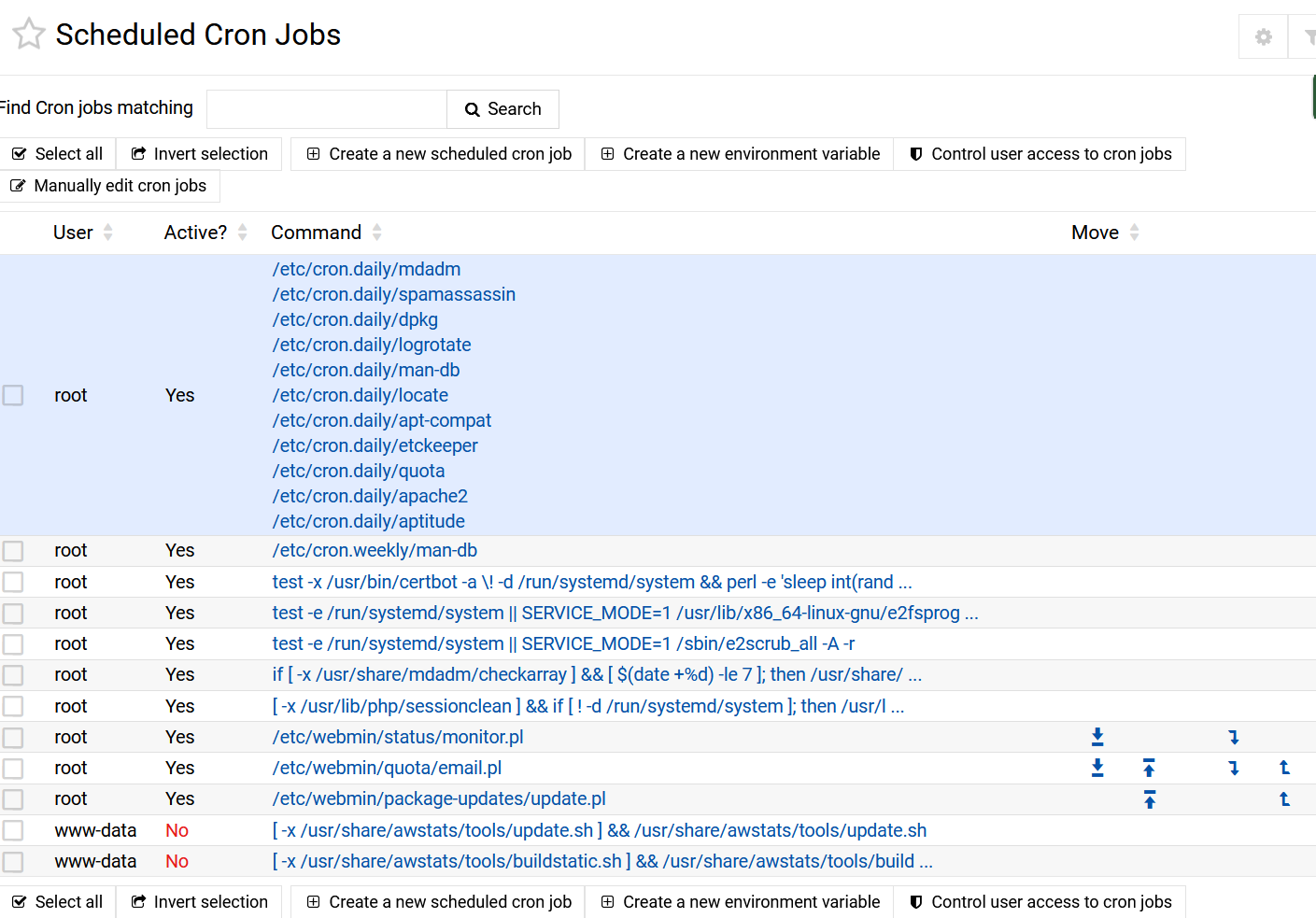

On the old debian 11 server webmin shows this:

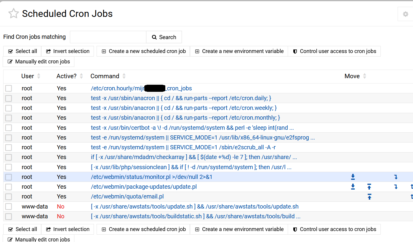

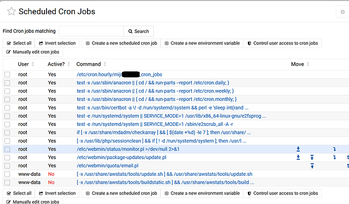

My new Debian 12 shows this:
Where have the daily (and weekly) jobs gone? The hourly is one I added.

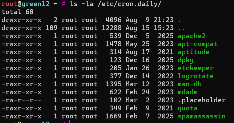

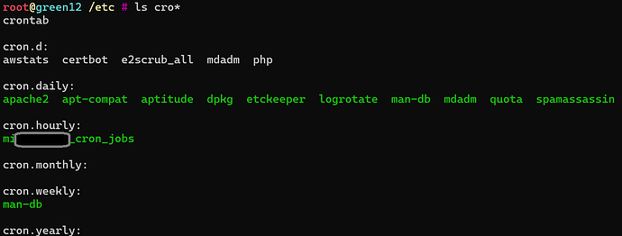

/etc/cron.daily/ shows them fine:

The screenshot above is from the Debian 12 system I just installed. Looks to an amateur like me as plenty of jobs. I was just clicking around and comparing the webmin’s on the old and new install and noticing the difference.
