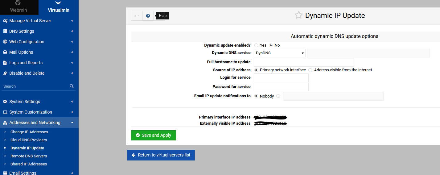

hello please is there a way I can create a dedicated server at home without a fixed IP address
Search the forum, seen discussion about it.
the DynDNS service
Yes, dynamic DNS is the ancient way of doing it and it still works. If you want something newer and better, look at Cloudflare Tunnels.
