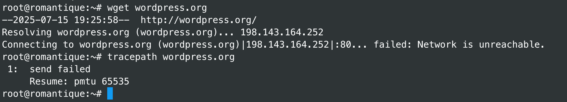

I’m using Ubuntu Server & Virtualmin. Some external sites/domains are not reachable, whereas others are!
If I do a wget Wordpress.org or wget virtualmin.com I get an error saying:
      failed: Network is unreachable.

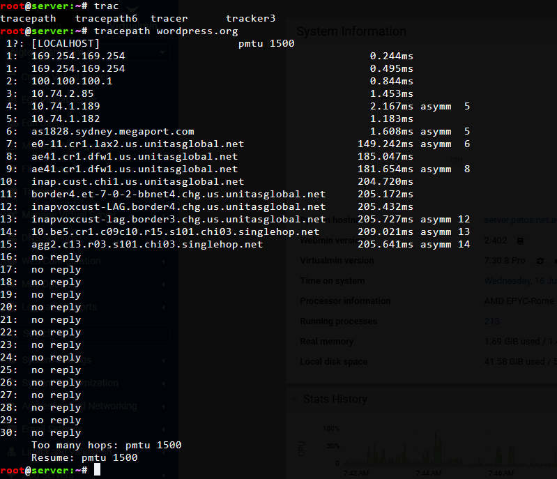

Tracert those names and see where the issue is. Looks like its called tracepath now.

Try pinging your gateway, and then the IP of some host outside of your local network as starting points for figuring out where things are going wrong.

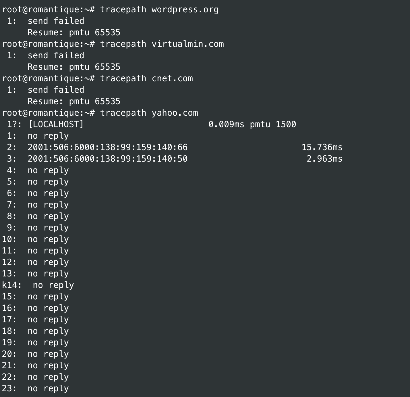

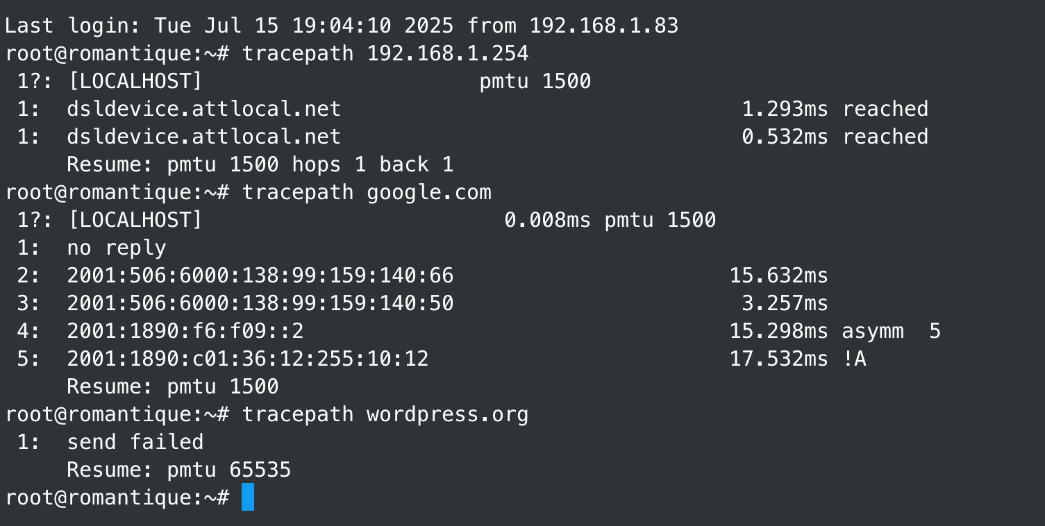

No, it’s not a DNS issue. Here is showing traceroute to my gateway, traceroute to Google.com (which both worked fine) and finally a trace to Wordpress which bombed. I’m so stumped. Ugh.

Do you have functioning IPv4 either locally or via a gateway?

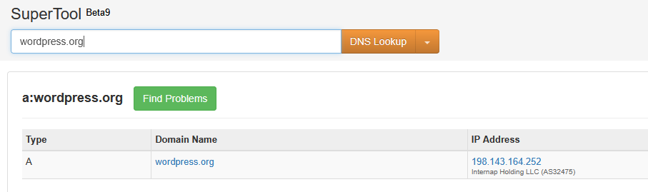

need ip4 for that domain
Sure. Yeah. Like I said - some domains work, others do not. I don’t understand that at all.
Yep. Same IP my server shows for Wordpress.org. It just won’t load/access/ connect to it! Damn. I finally got rockin and rollin on the development, now I’m gonna have to take 10 steps back and go back to square one and reinstall and resetup my whole damn server just over this crazy little weird thing. Except for this, everything is working how I need and want it to. Shit. It’s my first attempt at running my Linux web server locally, instead of paying a web host, and I’ve had so many headaches, and I had thought I finally had everything right and could now focus on my websites, but nooooo…screw that - the universe ain’t gonna let THAT happen! Ugh. SMH

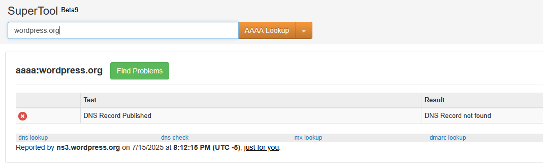

I have a hint for you:
joe@kate:~/Downloads$ host software.virtualmin.com
software.virtualmin.com has address 51.158.66.131
software.virtualmin.com has IPv6 address 2001:bc8:710:9a94:dc00:ff:fe82:8d31
joe@kate:~/Downloads$ host virtualmin.com
virtualmin.com has address 45.76.57.243
virtualmin.com mail is handled by 5 mail.virtualmin.com.
And, I think we answered this question: Crazy Network Problem?! This is a weird one, folks - I’m stumped - #12 by Joe
And, to go further, you can’t run a server on a system that doesn’t have a working path to all routable IPv4 addresses.
Having a public IPv4 address is also probably wise (though less important than it used to be, you’re going to have problems with some users being unable to reach you). e.g. my home network:
joe@kate:~/Downloads$ ping 2001:bc8:710:9a94:dc00:ff:fe82:8d31
ping: connect: Network is unreachable
