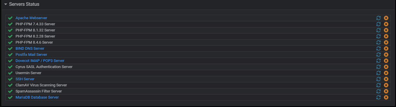

Did bind stop on your machine?
No, the bind work, the dns work for all the domains that are manualy created. The dns don’t to work for all the domains that was migrated from cpanel 1 week ago.
