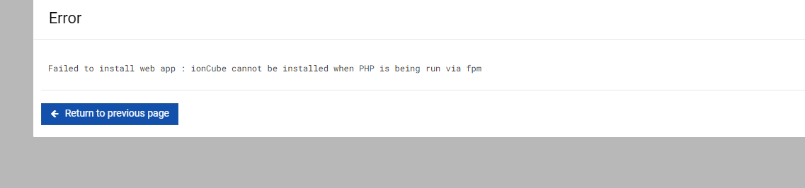

Could ionCube installation support be added for PHP-FPM?
I am using Virtualmin with PHP-FPM enabled for a virtual server, and when trying to install a web app that requires ionCube, the installer fails with this message:
Since PHP-FPM is a common and recommended PHP execution mode, I would like to ask whether support for installing or enabling ionCube with FPM could be added in Virtualmin.
At the moment, this limitation makes the installer unusable for apps that depend on ionCube unless the PHP execution mode is changed or ionCube is configured manually.
Is there any plan to add ionCube support for PHP-FPM in the installer?
Thank you.

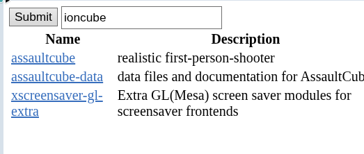

There are currently 3 ways of adding ioncube
  • for beginners to install packages using Webmin / System ⇾ Software Package Updates by listing only new packages and then searching for it,
  • Webmin → Tools → PHP configuration → Manage → Extensions → PHP Extensions → Add PHP extension
  • Or via the command line direct , I think this is correct apt-get install php8.1-ioncube
That may work for a debian system running php v8.1 but there is the point that 8.1 should be replaced with the version of php that you wish to install ioncube to, then as we don’t know if the OP is running some form of EL if so the above command is useless as apt does not exist in those environments and php is packaged differently so perhaps we need to know which operating system the OP is using
I can only find it as a direct download?

There is no official apt package for ionCube on Debian. The apt-get install php8.1-ioncube command does not exist in any official or standard Debian repository — it will simply return “package not found”.
The only supported installation method is a manual download of the loader binary directly from ioncube.com. Also worth noting: placing the loader in conf.d/ via a .ini file does not work with PHP-FPM regardless of the filename prefix — ionCube requires the zend_extension directive to be placed directly in the main php.ini file, before opcache.
