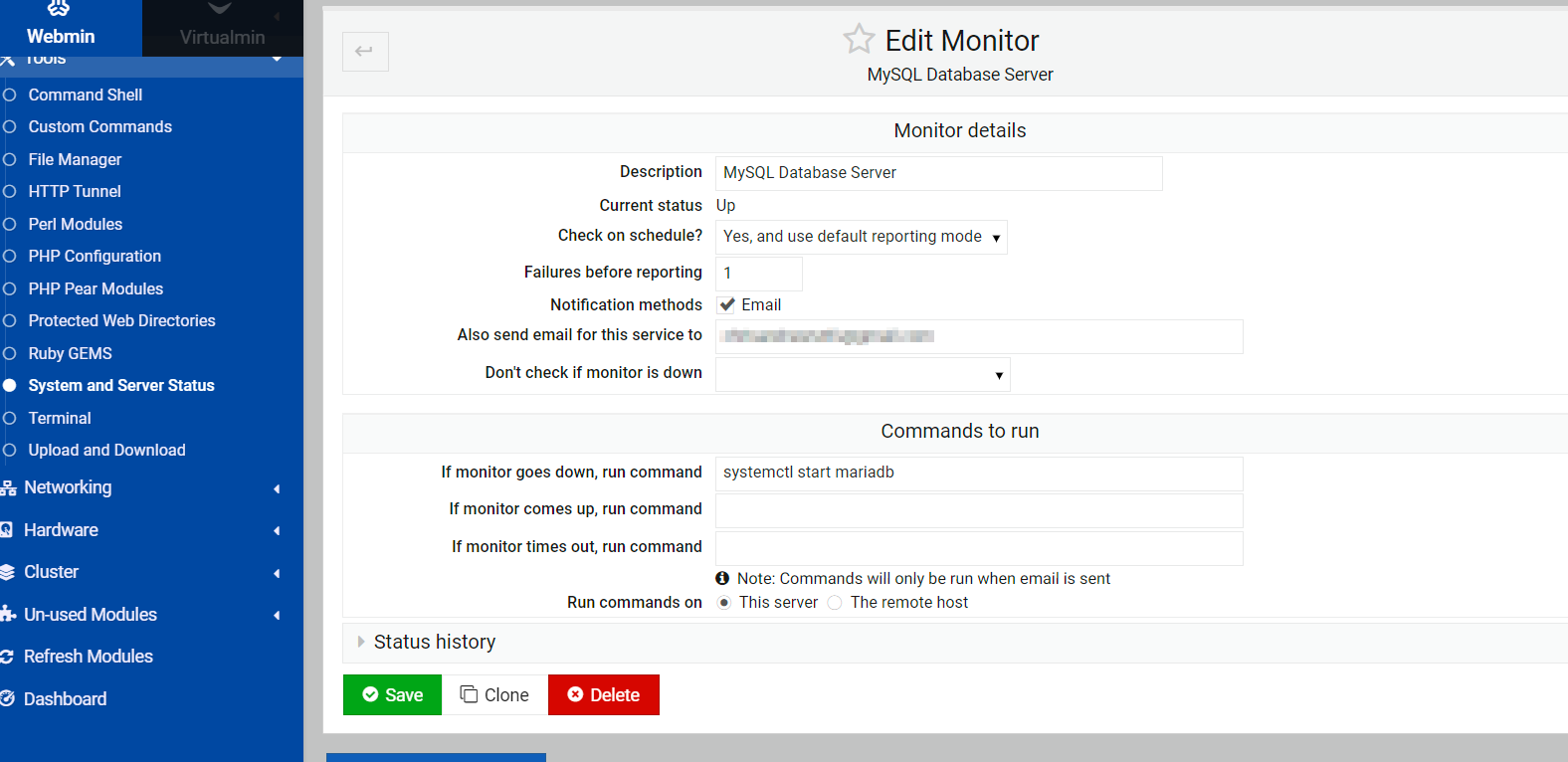

I need to automatically restart my database if mysql is bumped off for some reason.
I have the service being monitored and I receive the email if it goes offline.
I have the command to run if it goes down set to:
systemctl start mariadb
If I run that command through the Virtualmin command shell, it restarts the database.
But for some reason, the system monitor is not restarting the database when I am sent the email.
Any thoughts on where I’m going wrong here?

I had a play and it appears that you should have the email address in the setup and then don’t use the “also send email to”.
