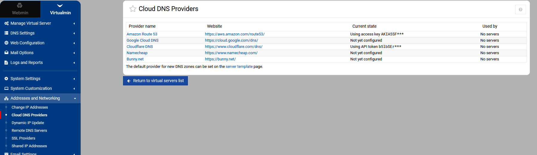

No, I let Virtualmin do all the editing of the entries in cloudflare. The quotation marks are missing at both DNS zones which I am currently maintaining (and Cloudflare is pointing it out). However, I am not sure what you mean by “cloud provider setting”. I have connected Virtualmin with cloudflare via an API token which was created in Cloudflare.

When using the Virtual min Cloud DNS Providers tool, it asks either for credentials or for an API token to be entered. The API token can be easily created within Cloudflare and then just needs to be copied in the Virtualmin dialog for Cloudflare. That’s also what the guide is describing.
