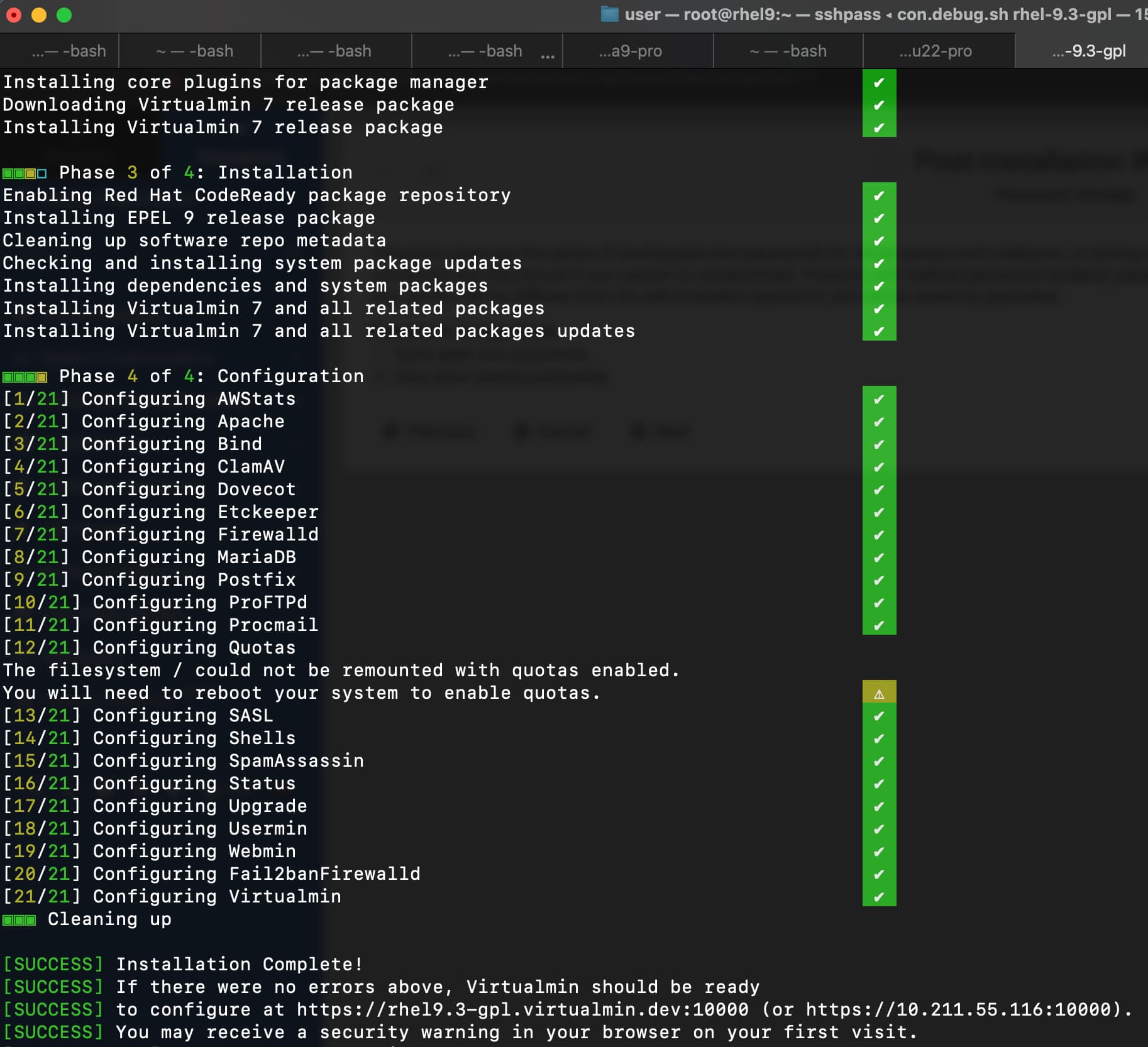

I tried clean install with RHEL 9.3 and it seems at first glance to work just as it always did with XFS, i.e. requiring to reboot the system to enable quotas:
However, quotas aren’t enabled after reboot. We will have a closer look! Thanks for the heads up!
I have taken a deeper look into it and it isn’t clear why xfs_quota -x -c 'report' returns nothing even though quotas are clearly enabled in /etc/fstab and /etc/default/grub. Also running xfs_quota -x -c 'limit bsoft=500m bhard=550m user1' / returns:
