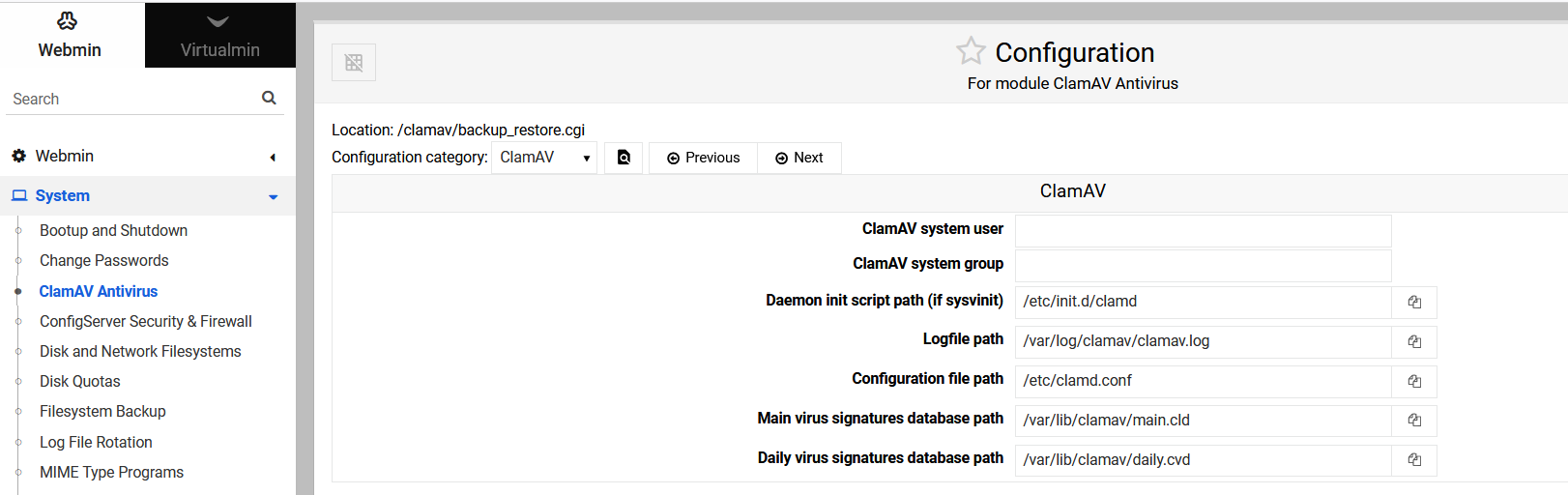

I just noticed this issue with ClamAV when I decided to check my Antivirus setup. I have no idea how long its been like that or if its even working properly. I ran freshclam manually and it appears to work and when I check in the Bootup and Shutdown section clamd@scan.service says its active(running)
This is what I see in Webmin:
If I select the config (upper left) I can view some configuration settings but can’t do anything. There must be something set incorrectly but I have no idea what. I am not sure of the proper paths in Centos 7.9

That’s not our module. I didn’t even know there was a ClamAV Webmin module.
But, it looks like it’s trying to use old sysvinit scripts, which isn’t a thing anymore.
Thanks Joe. I’ll remove the module.
I removed the module so I no longer see anything for clamAV in Webmin.
