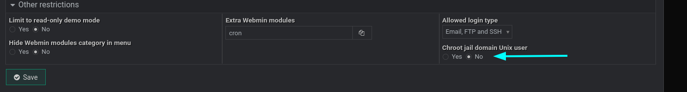

The site I tested this with was chrooted, which was apparently the problem. When I turned off the chroot on the site, the issue disappeared.
Can anyone help me understand why this is? In other control panels on boxes I operate, chrooting web spaces for WordPress use has never stopped email from being used from them. Is something set up differently for the chroot process done in Virtualmin?
Also, once I remove the chroot from a site, the chroot directory for that site is not removed by Virtualmin. Shouldn’t it be?

You need to add anything you want your chrooted user to be able to use to the jail. To use sendmail, you need to add that command and its libraries to the jail, either using the jk_cp command or adding it to the config file for the jail being created for your users (there are several included jail configs, we default to a quite limited one, for security reasons).
This is true of any use of a jail, regardless of control panel being used to manage things. A chrooted user only sees what you put in their chroot. If you want them to use PHP, you gotta give them php (and maybe the specific extra versions they need, if any). If you want them to send mail, you’ve gotta give them sendmail. As I said, there are some defaults included with Jailkit, or you can make your own and tell Virtualmin to use it.
The point of a chroot is to restrict what the user can and can’t see and do. It’s quite restrictive by default (and by necessity…it’s not all that hard to accidentally give users the ability to escape the chroot).

To send mail using the sendmail command, you need to add the sendmail command to the jail, either via jk_cp (for one user jail) or by adding it to the jail configuration file (which will add it to future created jails).
Ok, bear with me while I try to wrap my brain around this - does this mean sending the user out of the jail to use sendmail or copying all of sendmail in its directory structure into the jail?
Is it possible that without the sendmail being set up correctly, the condition could occur that there’d be no error or anything else obvious from within the jail when one tried sending mail from in the jail?
It means neither.
It means literally using the jk_cp command to copy one command (sendmail) into the jail. The jk_cp command copies all library dependencies into the jail, as well.
I don’t know what this means. But, there was an error when you tried to send mail from within the jail; it was a command not found error, and it was because sendmail was not in the jail.
