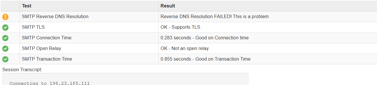

What does mx tools respond with.
Thanks, Looks like my RDS is the culprit.

That shouldn’t cause a timeout, reverse more effects delivery of your mail, the recieving server will reject the connection, that shouldn’t be a timeout.
Seems like connection to your server on port 25 is working.
