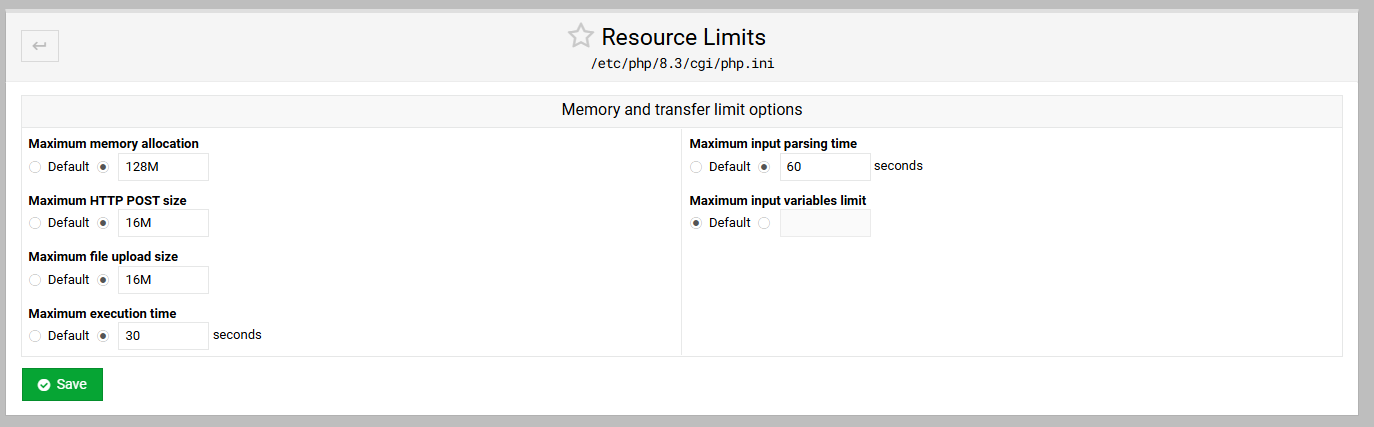

Under Webmin => Tools = > PHP Configuration, I am editing /etc/php/8.3/cgi/php.ini
I click on Manage, then Resource Limits, and set the values I want:
But when I check an application (within Joomla), or phpinfo from a server / site, the resource settings do not match:
Am I missing something, that would cause the values to be ignored or overridden?
OK, it looks like if I modify the settings for that server / domain, it updates correctly. My question now becomes - why is it not respecting the global values set in Webmin?

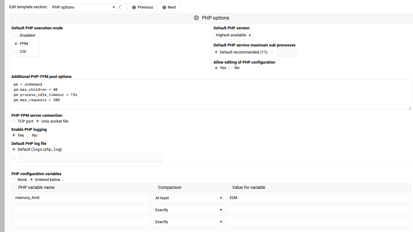

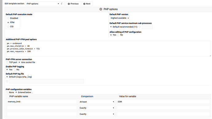

Then maybe use the template settings?
Server Templates are supposed to apply at domain creation time, and changes made to Server Templates now won’t alter domains created in the past.
