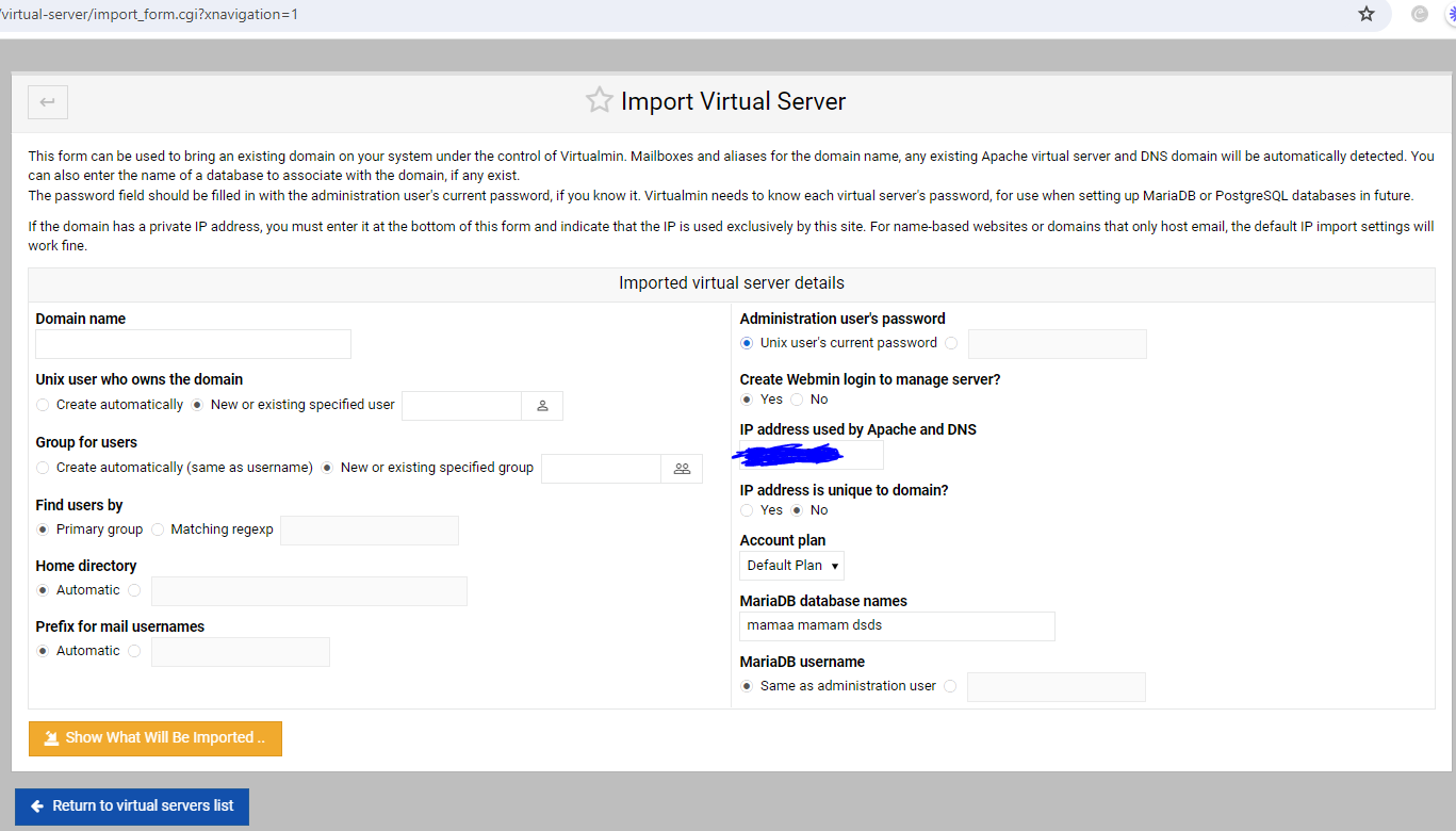

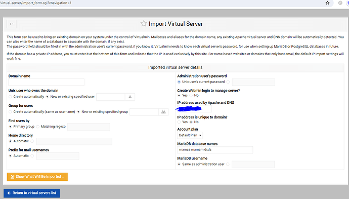

So below is how you mean to import the domains right? Or is there another way?
Could you please hint me what will Find users by do? Which users will be found? Shall I leave it to Primary group? Is it better to leave home dir and prefix to automatic? How can I find the maria DB databases and username? Do I need to put comma or space between Database names?
Any other hints for my situation to make things better is mostly appreciated!
I can’t tell you wat to do, but just wonder. My hoster has the option to install a fresh image of choice of distro. When I messed up my server when I first started with virtualmin, I reinstalled that image so the server was fresh and clean. Did only sudo update/upgrade and then installed virtualmin again. After that I imported all the websites again. It only took me about an hour and most of that time was caused by the upload time of all the data.
Since your server seems quite a mess now, is there no way for you to do such a clean start? Just asking, don’t directly execute it :wink:
That is what I mean, and what I explicitly told you you need to do. I don’t know how to be more clear. If you want Virtualmin to know about and manage your domains that aren’t currently associated with Virtualmin, you need to Import them using the Add Servers->Import Virtual Server feature (as I said above, and the screen you’re showing).
That will find users “owned by” the domain, e.g. mail and FTP users. There is no concept of domains at the OS level; but Virtualmin sets them up using a common convention of having them all in the same group (the group of the domain owner user). Since you created everything with Virtualmin, most of the default settings are the right ones; these are somewhat common conventions, but not rules or enforced by the OS or anything like that (again, the OS has no idea what a website is or domains or users owned by a domain, we just sort of create a directory structure and a group that kinda looks like it does).
Probably? I believe it will use the home directory associated with the user, so that should do the right thing. The only way this could get weird is if you made dramatic changes to the Virtualmin configuration in those areas from before, when you originally made those domains. If you left user homes in /home and mail/ftp users in /home/domain/homes, you probably will have a very easy time bringing them in.
You don’t know what databases you’ve created? There will be an automatic database created if you enabled database for the domain, and it will have the same name as the domain (within the limits MySQL/Mariadb imposes), so if you look at your list of databases it should be obvious which ones were created by Virtualmin as part of the domain creation. Extra databases may be best left until after you’ve imported the domain (and then use the “Import Database” feature in the “Edit Databases” page for the domain), just to keep the import of the domain as simple as possible. If the website is working, it’s probably already got the right permissions for the users.
I’d recommend you do this one domain at a time, checking the state of things after. Since you created all these domains in Virtualmin, it will probably mostly Just Work, but some metadata was certainly lost when all the Virtualmin config files were lost.
