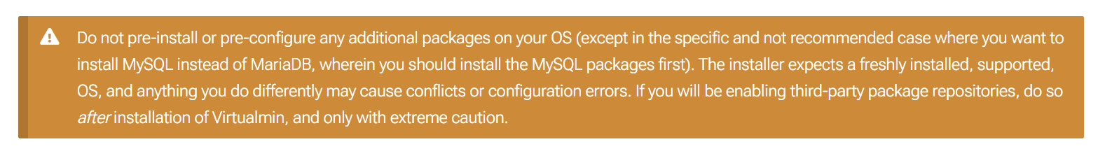

That is a while … perhaps there was a custom image laid down by your provider. Perhaps exit the process and check what has installed up to this point. I can’t remember if the installer leaves a log file, if it does check that out to see what the installer is having a problem with. If there is a log file it will be in the same directory as the installer script
Your provider when they commisioned the vps, assuming it is a vps, may have added/removed packages from the default which may cause an issue. My provider adds tmux to their install which in fact saves me a job.I would find out where it has failed first. The installer uses apt to install the packages required and apt may have failed and is in a loop
