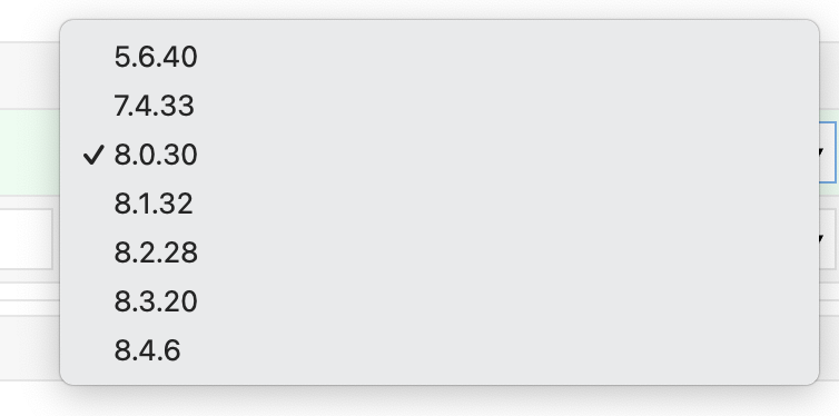

I have the choice of choosing different versions of PHP : i don’t remember having done anything manually to get the ability to switch to the latest versions of php 8.3 so I presume it is done with the updates i can make with Virtualmin and all packages (including the Sury repository)
Here is the choice i have to switch PHP
My issue is that PHP > 8.0 have not imagick or gd installed and i would like to add them and I don’t suceed with only apt-get, they doesn’t seem to be available in the repository, is there a way i have not found ? and yes I understand that installing imagick on a specific version is not a Virtualmin task but I would love to do it without breaking anything in Virtualmin of course :slight_smile:

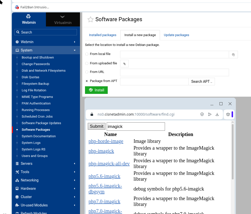

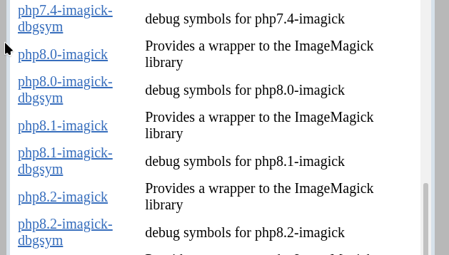

My preferred method for the OP to try would be:
Note further down the list:
Debian here so it should be the same repos.

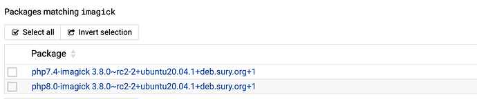

I tried to look at the Software package as [ID10T] proposes
Only 7.4 and 8.0 available
