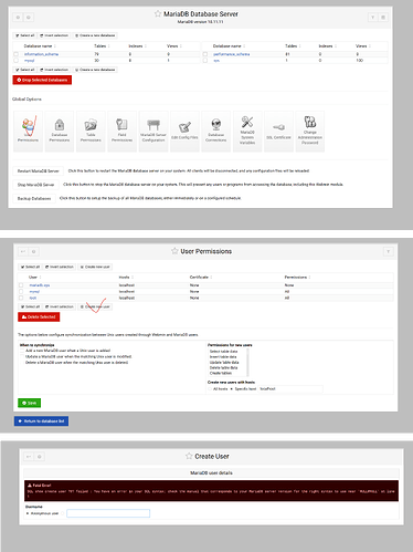

Getting error when trying to add new user to MariaDB from “User Permissions > Create New User”
SQL show create user ?@? failed : You have an error in your SQL syntax; check the manual that corresponds to your MariaDB server version for the right syntax to use near ‘NULL@NULL’ at line 1

Can you take a screenshot of the screen just before submitting the request, so we can see if there are any errors in the form.
Hello, Peter!

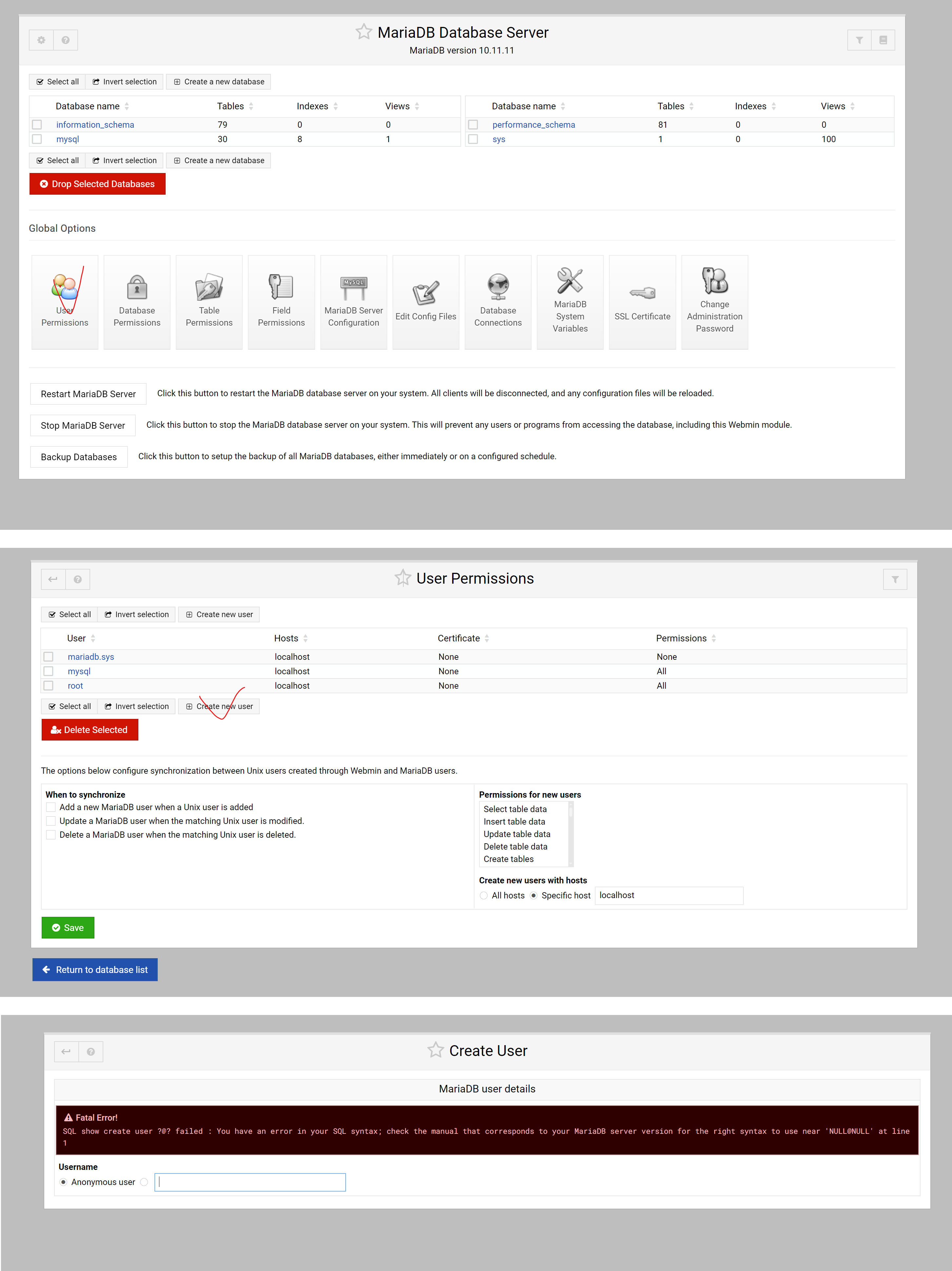

Here is a combined screenshot. Fresh debian 12 install and Webmin. I even have purged mariadb and reinstalled from within webmin. No change.

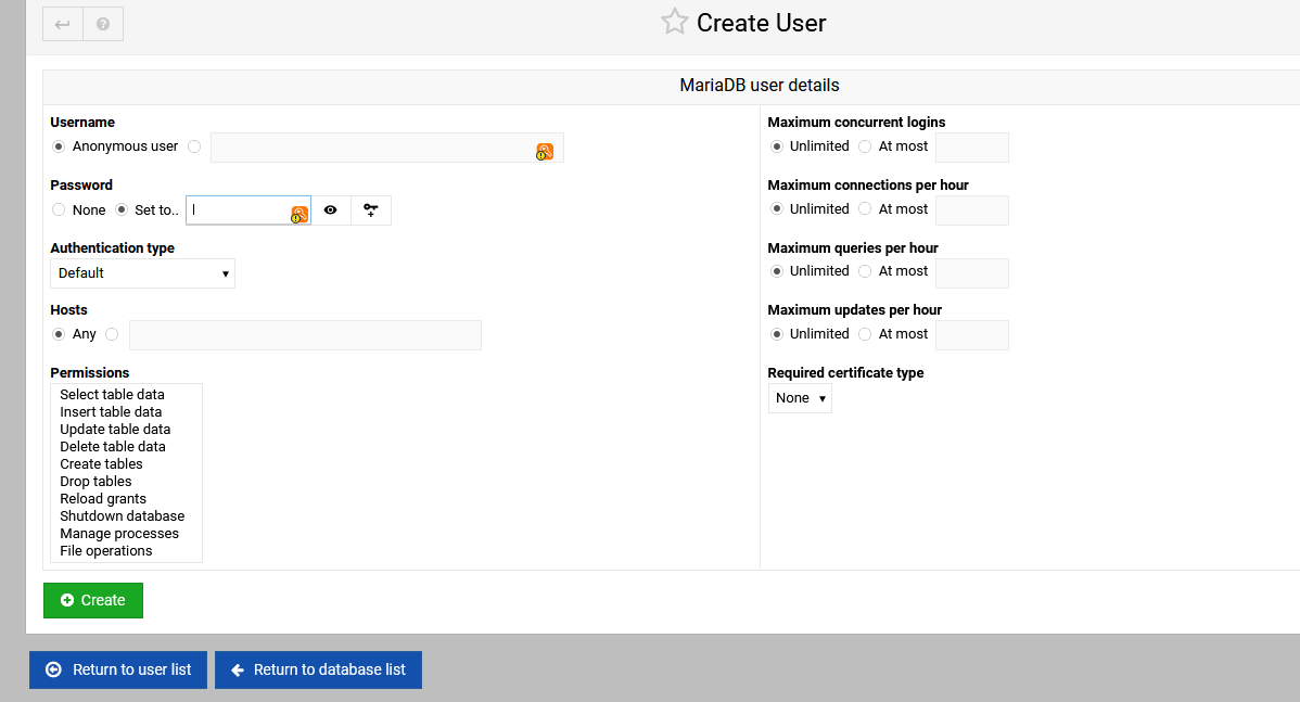

@POPOV,
Did you actually specify a username before you submitted the form, the field looks empty and is set to “Anonymous”.
there should be another form
There is no form. Just the error. Here is step by step
  1. From the left menu , go to MariaDB Database Server
  2. Goto User Premissions
  3. Click “Create New User”
  4. The error appear like the screenshot bellow

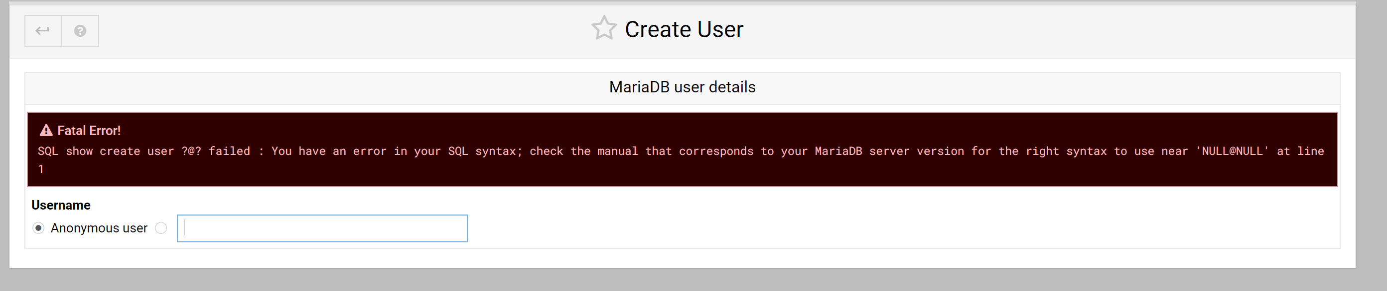

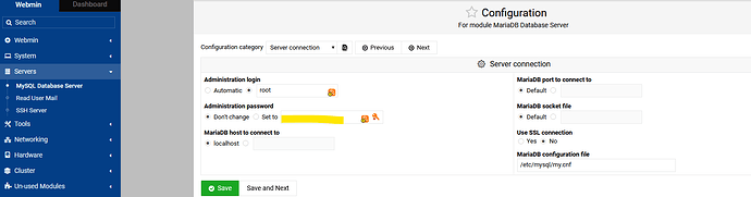

I just installed Debian 12 and I get the same issue. I thought it maybe the root user not having a password but I created and added pasword into config
but I get same error.
Following these docs to add password.

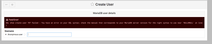

Just installed clean Alma Linux 9 x64 and install mariadb server and still getting the same error.
I can create a database ok in the UI but the create user it produces same error output at OP.
