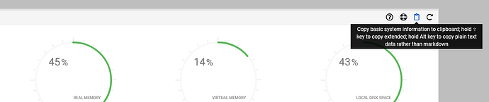

Can you copy your system info from here.

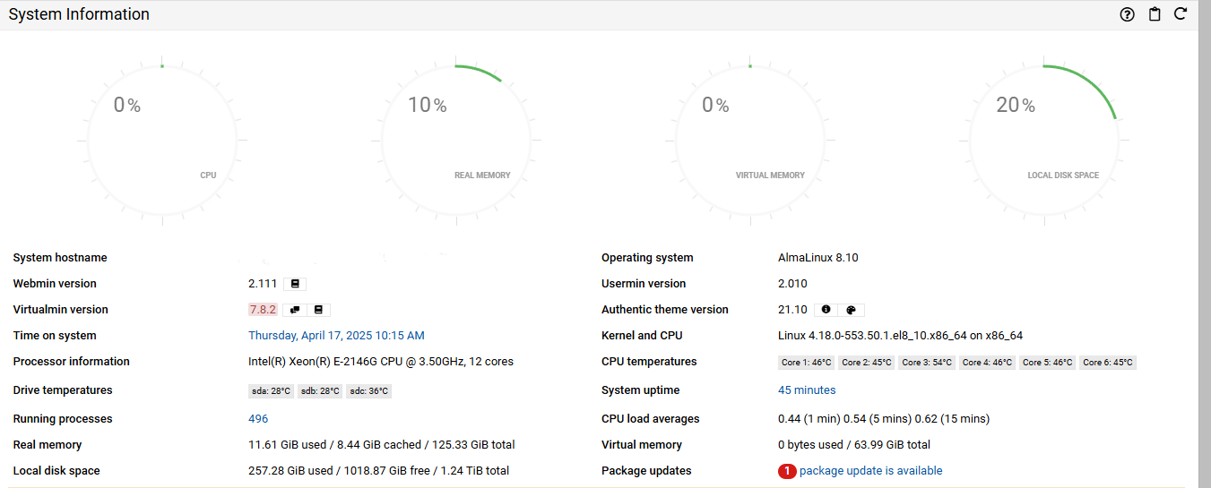

this update I get…
both webmin & virtualmin are out of date, perhaps check that you are using the correct repositories , you should be using version 7 & not version 6, if this is the case just update to the newer repositories and everything should be good
please tell me how to do it. thanks
You need to update your repos.
Thanks for the solution! :hugs: :hugs:
