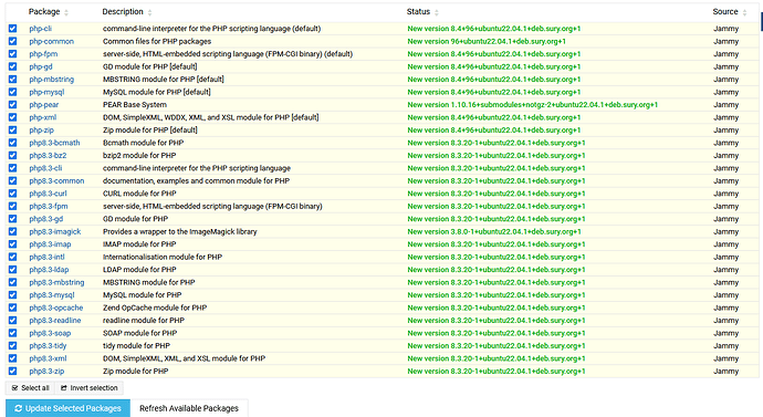

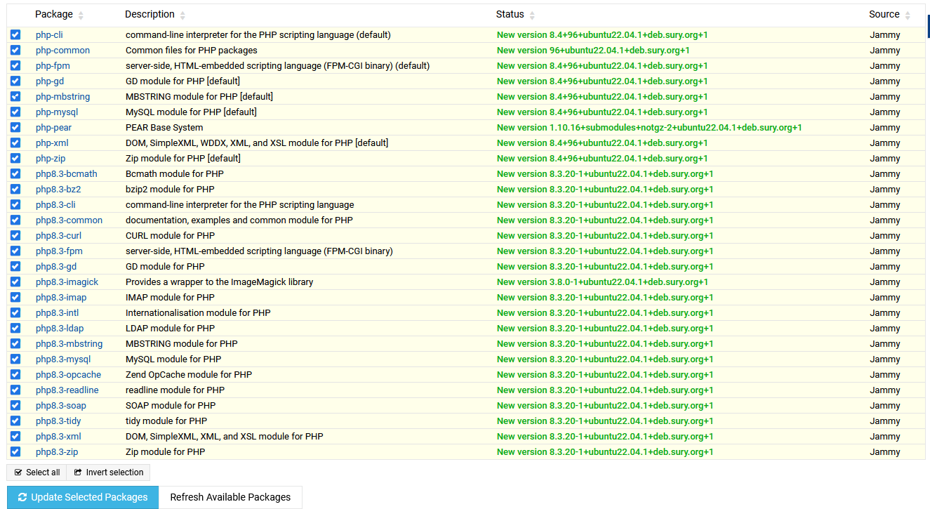

I filtered and installed by PHP version number and this is what happened:
  • 7.4, 8.1, 8.2 = updated
  • 8.3, and 8.4 (now default PHP) = still fail
This is what is left

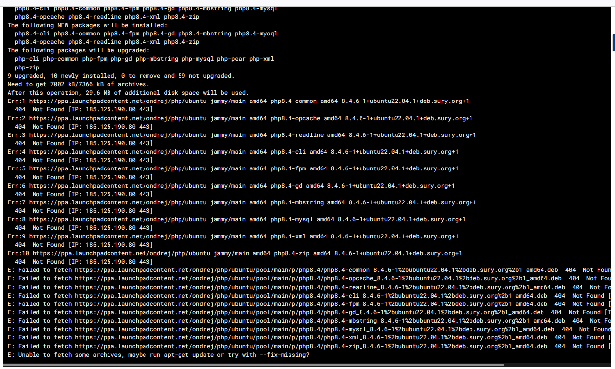

So I can connect to the ondre repo but there is something wrong with PHP 8.3 and 8.4
Obviously t is finding the package as they are listed in the updates. I have refreshed the package list but this makes no difference.
Any thoughts?

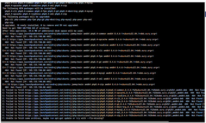

If you consider this file it does not exists
there is a similar one with a different version number, php8.4-common_8.4.8-1
So this must be an issue with the repo and package list presentation unless there is another sort of package refresh I need to do on my end.
https://ppa.launchpadcontent.net/ondrej/php/ubuntu/dists/jammy/main/binary-amd64/
This lists:
pool/main/p/php8.4/php8.4-common_8.4.8-1+ubuntu22.04.1+deb.sury.org+1_amd64.deb
So is there a caching inssue on my server?
  • I thought the refresh package list should refresh the cache?
  • I also disabled the cache option in the modules settings and did a refresh, but got the same error.
apt clean
apt update
Then try again.
that fixed it and during the commands I got the following message which you might of expected.
