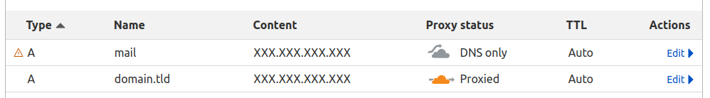

On Cloudflare, I entered all the DNS correctly (I reported them just in case):
#xxx.xxx.xxx.xxx is the IP of my VPS:
A admin xxx.xxx.xxx.xxx
A autoconfig xxx.xxx.xxx.xxx
A autodiscover xxx.xxx.xxx.xxx
A mail xxx.xxx.xxx.xxx
A trelune.tech xxx.xxx.xxx.xxx
A webmail xxx.xxx.xxx.xxx
A www xxx.xxx.xxx.xxx
MX domain.tld 5 mail.domain.tld
TXT xxxxxx._domainkey v=DKIM1; k=rsa; t=s; p=PUBLIC_KEY
TXT _dmarc v=DMARC1....
TXT domain.tld v=spf1 ip4:xxx.xxx.xxx.xxx

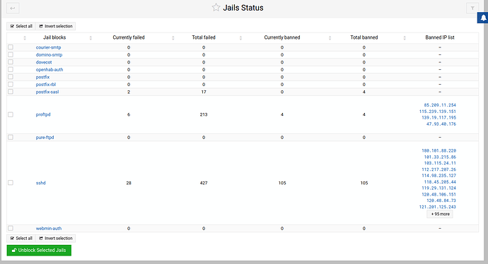

-I configured fail2ban correctly, but the IP address of my device does not appear in the “jail”. Even by stopping the “fail2ban” service, the problem does not change.

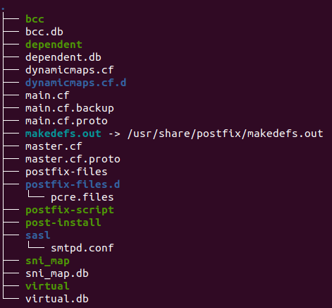

For completeness, I also report the /etc/postfix/main.cf file
(Removing check_policy_service inet:127.0.0.1:10023 from the smtpd_recipient_restrictions resolved the issue where incoming emails were not delivered).
