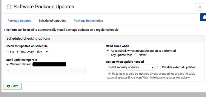

you can fully control security updates
I am on the side of not making Webmin too top heavy with extra code.
I have security updates set to get installed so I only get notified once.
The non- security updates I get notified every hour like you. I just decided that it’s not too hard for me to delete them.
If for any reason I am unable to access my mailbox at least once a day then I would edit the cron and slow it down a lot. Is there any point to having it check every hour if nothing is then done about it? I might do it anyway.
Or I might set it to install all updates so there will only ever be one notification.

That’s a good suggestion, easy to implement and we’ll look to include it in the Webmin 2.660 release.
A new option, “New updates are found or an update action is performed,” will be added to the “Send email when” field to do exactly what you suggested.
