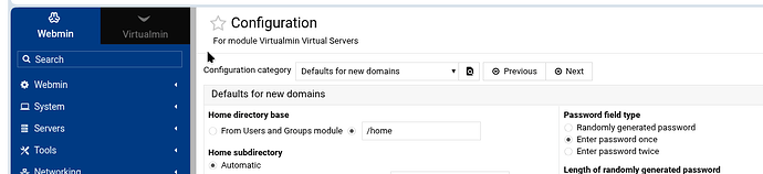

I’m not ‘authoritative’ but you can set an alternative here. I don’t know if that messes with anything else. You just add the disk and change the default? I haven’t tried this and I’m sure someone from the staff will confirm or deny once they get to the thread. :wink:

Well, the main point stands. Change the template to where you want to add the new VM’s.
