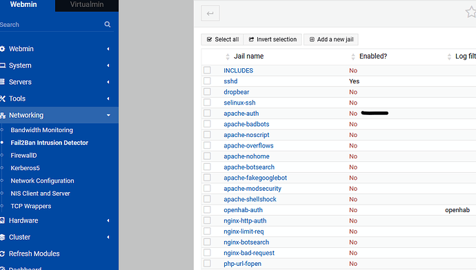

I restarted Fail2ban and then I triggered some 401 errors but my ip does not show up in fail2ban logs. What am I doing wrong?
default is off, have you turned on?
Yes. It is on
how many fails did you do?
Maybe log path is wrong?

You were right. I guess I was sleep deprived. Didn’t see the problem right in front of me.
apache-auth looks in the error logs, not access logs. Created a new filter and jail and it worked.
