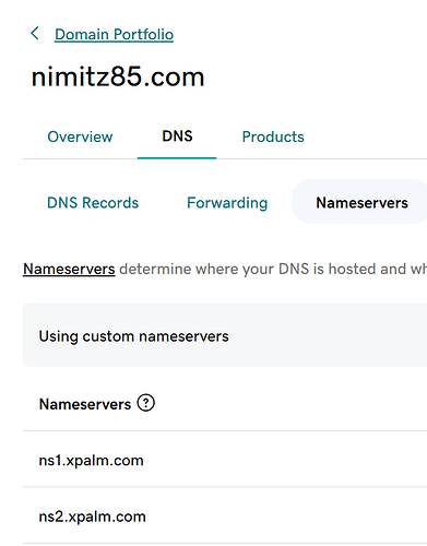

I’m not familiar with the terminology, but my domain is pointing to the DNS server on my host:
I have two other virual hosts/domains that are working on the same host.

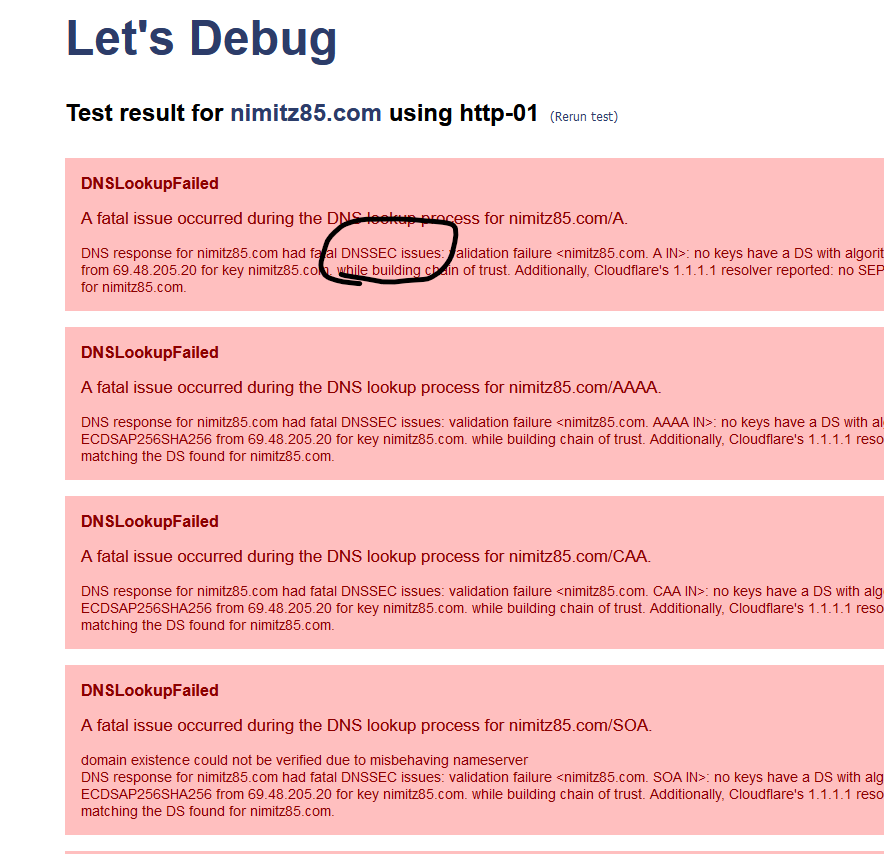

Let’s enrypt works for the other virtual servers, but I get this:
Domain: nimitz85.com
Type: dns
Detail: DNS problem: looking up A for nimitz85.com: DNSSEC: Bogus: validation failure <nimitz85.com. A IN>: no keys have a DS with algorithm ECDSAP256SHA256 from 69.48.205.20 for key nimitz85.com. while building chain of trust; DNS problem: looking up AAAA for nimitz85.com: DNSSEC: Bogus: validation failure <nimitz85.com. AAAA IN>: no keys have a DS with algorithm ECDSAP256SHA256 from 69.48.205.20 for key nimitz85.com. while building chain of trust

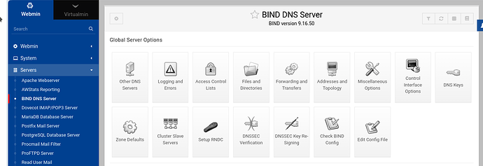

root@main:~# named-checkconf /etc/bind/named.conf /etc/bind/named.conf.options:30: option 'dnssec-enable' is obsolete and should be removed
Note the ‘check bind config’ option.

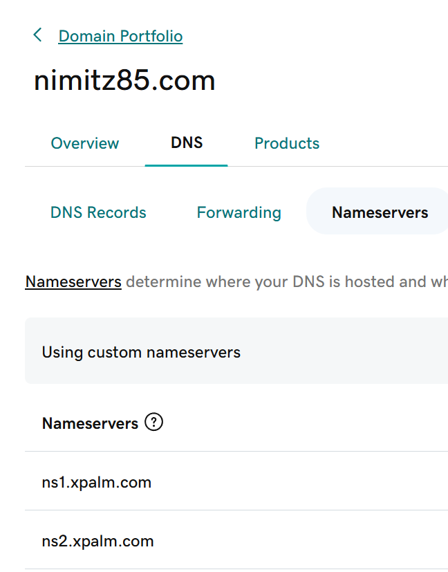

Whois does show:
Name Server: NS1.XPALM.COM
Name Server: NS2.XPALM.COM

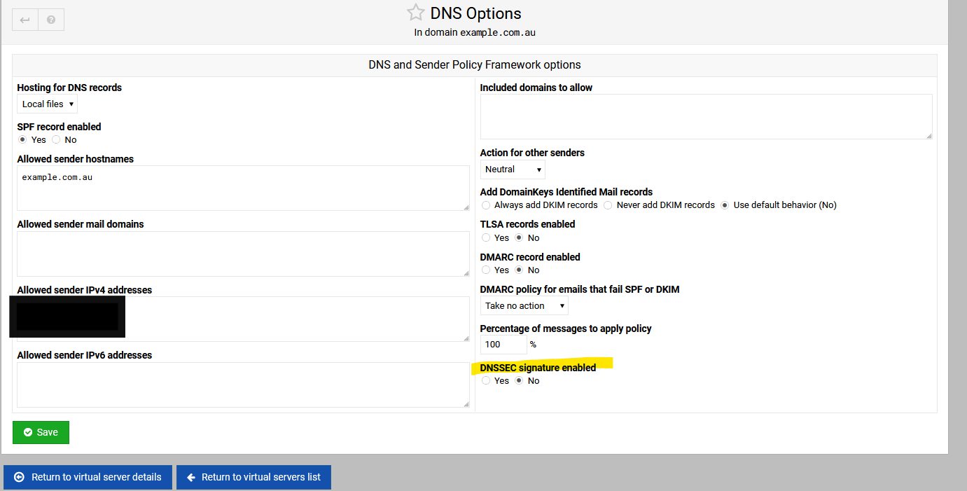

Seem like you have DNSSEC setup that need keys. Turn this option off. That make life more complicated,
I’m not sure where you have added this, could be registrar (most likely) or in virtualmin.
Someone else may have experience with this I never use it.
There is mention of cloudflare there.
If it is in virtualmin disable here.

The RCA is I had previously set all the DNS records set at Godaddy, When I changed it to the two DNS servers, godaddy retained the DS records for the domain, causing the problems.
I set it back to the details, deleted all the records and then set it back to just the 2 name servers.
