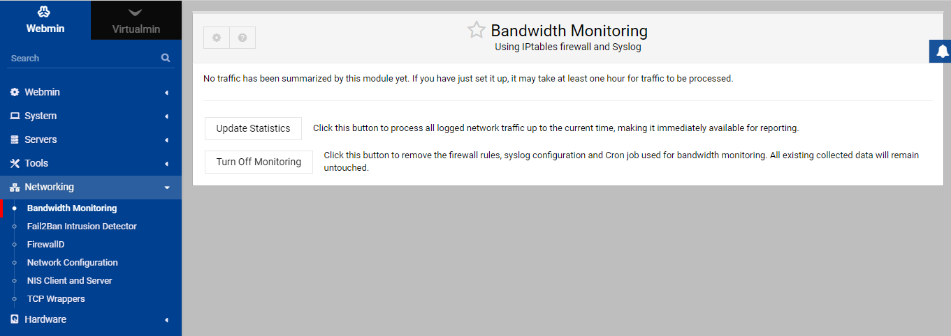

@Joe I cant see any logs in bandwidth monitoring module. But /var/log/bandwidth has the Network Logs. I waited for like 12 hours and still no log in bandwidth monitoring module but logs are coming in /var/log/bandwidth that was created by the module. Is it some kind of bug or its just happening with me. Same thing happening on my all 3 VPS But Bandwidth Monitoring In Virtualmin Section is working perfectly, I can see bandwidth usages of all my virtual servers but same module in webmin section is not working.

@Joe @Ilia UPDATE: In ubuntu server 22.04 and Debain 11 its working perfectly but not working in debain 12. I have rsyslog installed in debain 12.
