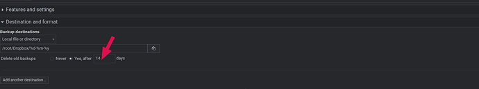

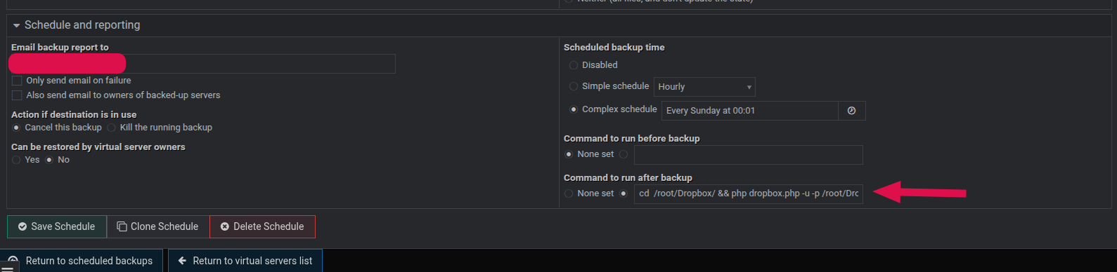

I wrote a script that is ran after the backup like this

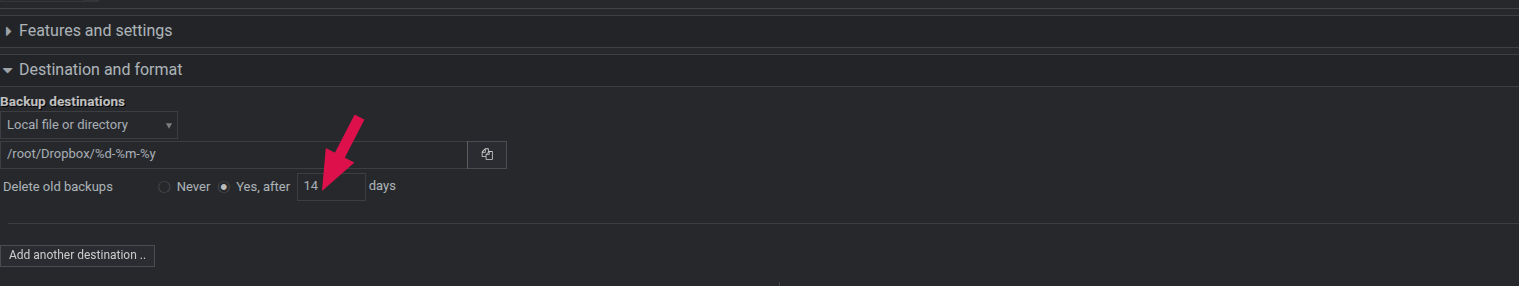

within that script I know where the backup is located and it’s file name, so it’s just a case of then moving/copying it to wherever you want. To help debugging your script the output from the script is saved in miniserv.err weather it fails or not so you have a reference to look at. with regards to file name to transfer just make it something like this /root/backup/%d-%m-%y for a directory then just loop through the files in that directory so you don’t need any variables all you need to know is the date, which is very simple to get in a script. Then get virtualmin to delete the older local backups using the gui
