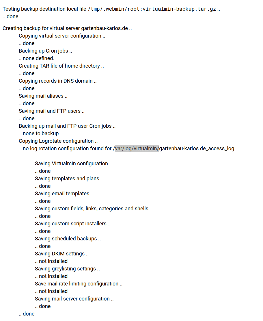

I want to create a backup for 2 of my virtualservers Virtualmin > Backup and Restore.
But following issues happen:
  1. I’ve used the “download-link” option, but there isn’t any link shown after Backup finished, just this page:
  2. Virtualmin > Backup and Restore > Backup logs are empty
  3. Virtualmin > Backup and Restore > Running Backups show “No virtualmin backups are currently running”
  4. Virtualmin > Backup and Restore > Scheduled Backups show: “No scheduled backups have been created yet.”
  5. /tmp/.webmin just contain:
That’s it! Any Idea why backup not work at all, and how to figure out where the issue might be? Are there logs to check for this?

The UI is a bit confusing to me… you just need to mark the entries in the left area and must not move it left over!!

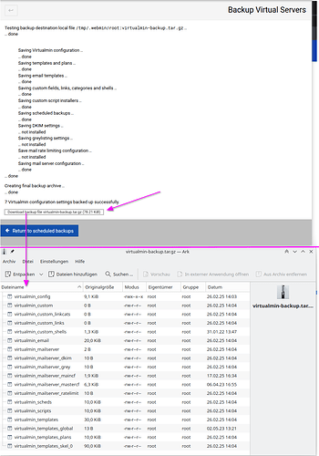

Then I got a download link in the next screen… BUT the file only contain virtualmin_config files, and not any data of the virtualservers at all. Isn’t this backup-section to “also” backup the whole data of the Virtualserver?

in the downloaded archive are you not seeing something like this ?
blocked out is the domain name, but each file contains what I would expect
@jimr1
Nothing like that. Above in the Screenshot is the whole virtualmin-backup.tar.gz file shown.

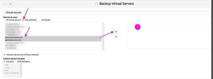

As I have to move them over else they are not backed up
To be honest… the Dialog is a bit confusing to me.
1st try
First I’ve ticked the Radio-Button “Only selected…”, select the both domains and move them over to the right side:
But this seems to be wrong as this don’t create any backup-file at all.
2nd try

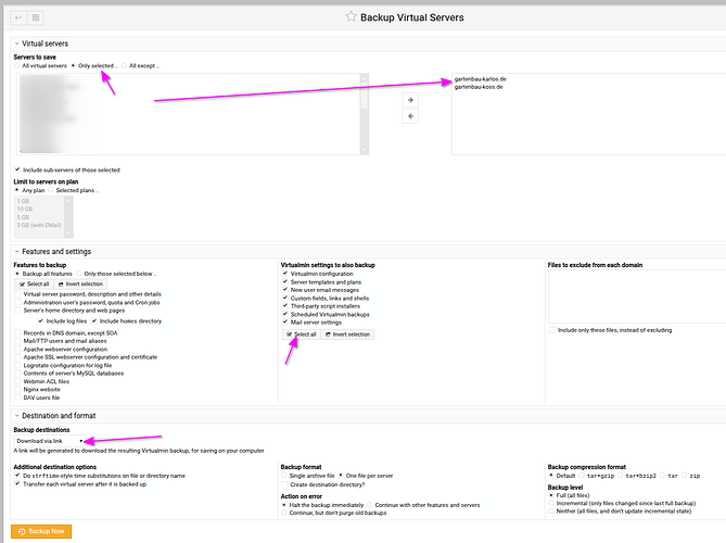

Then I’ve ticket the Radio-Button “Only selected…”, select the both domains and DON’T move them over to the right side - keep them just marked on left side.
The result was as shown… just a tar.gz File with virtualmin files inside.

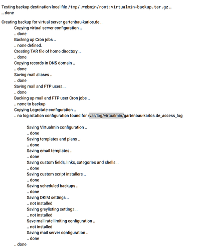

Oh OK I move the domains to the right and that works for me as you can see from the screen shot of the downloaded archive
What do you select on the radio-buttons? Also the “Only selected…”?
But I’ll give it a try again now and see what happend.
Yep, like before.
Just see this output, with no Link at all:

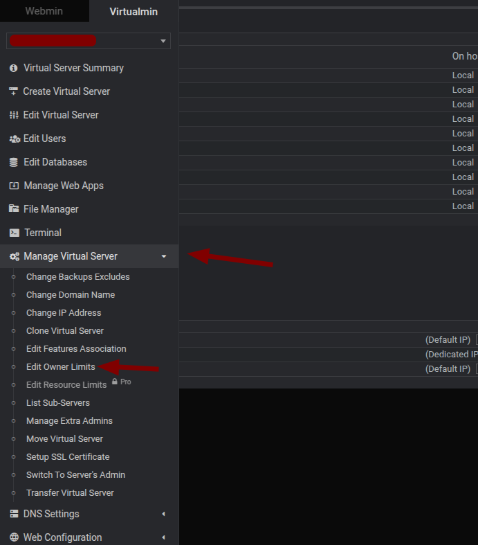

@jimr1 wasn’t there a way for the “customer” to create backups for his virtualserver via the UI at his own?
If you give them permission to the module yes they can
virtualmin->domain->manage virtual server->edit owner limits
I don’t find manage virtual server, could you please show me a sceenshot of it?
Backups are activated in my plan for those users.
here you go

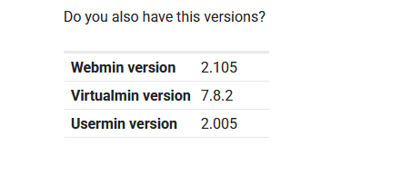

Do you also have this versions?
Webmin version 2.105
Virtualmin version 7.8.2
Usermin version 2.005
thats a bit confusing, I don’t know that version.

This may show how far behind you are
the versions are a bit confusing.
I would update to a newer version of virtualmin/webmin running older version may lead to problems
It should be the recent version I have… at the virtualmin webpage I see same Versions in the Screenshot:
Might it be, that the Pro-Version No. and the GPL ones differ?
I don’t remember how I’ve installed Webmin / Virtualmin at this Server. Might it be that it was via apt, and the repositories of Ubuntu Linux 22.04.5 are outdated?
