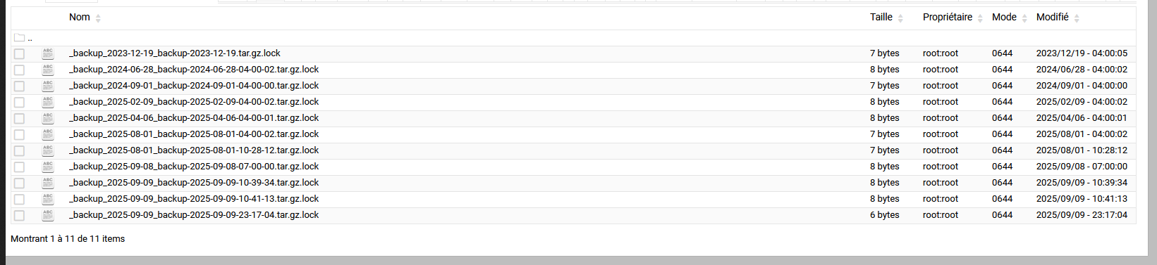

There is really nothing to do: the "/var/webmin/locks" folder is currently empty (I haven’t deleted anything)
in the folder "/var/webmin/modules/virtual-server/backuplocks" there is this:
Won’t I break anything if I delete all the .lock files?
If a backup is not running it will not break anything.
