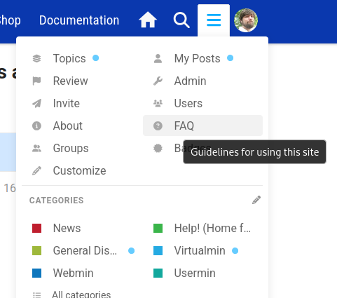

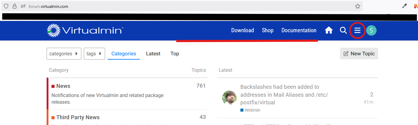

Could the Guidelines be put in the menu(s)
They are in the menu (labeled FAQ).
The guidelines are also linked quite clearly in a very large top-of-page banner that exists until you dismiss it (this is a recent thing, Ilia just added it a week or two ago).

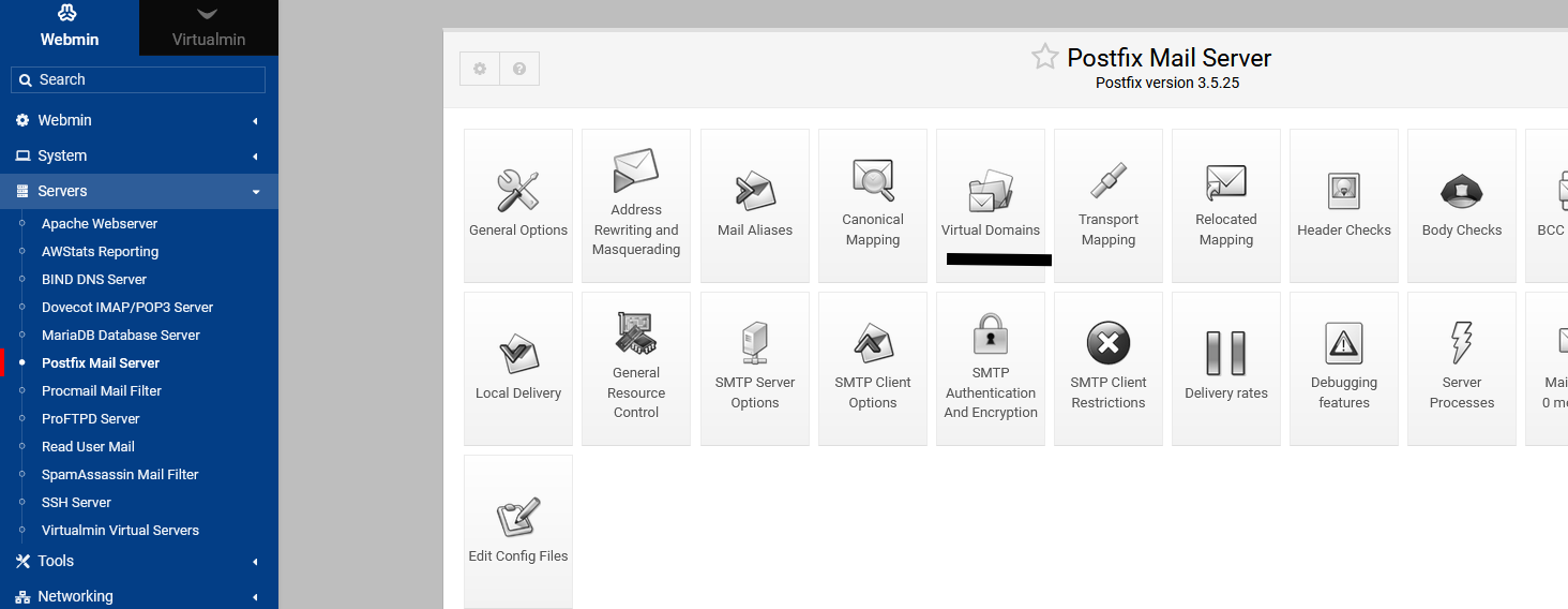

I cannot relate to stefans post, because I can not locate where you took the screenshot.

Where did you take the screenshot? I cannot locate it in virtualmin.. :slight_smile:

What page is this from?
