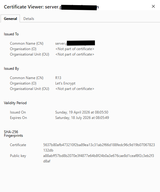

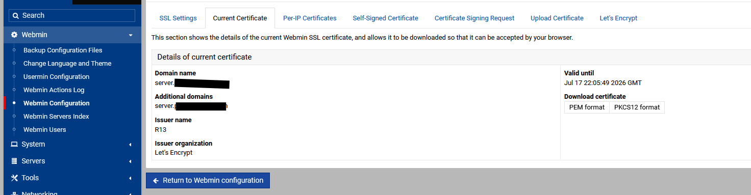

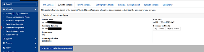

Its only generates one Let Encrypt certificate for the hostname, I see no wildcard generations.
Also in Webmin Config

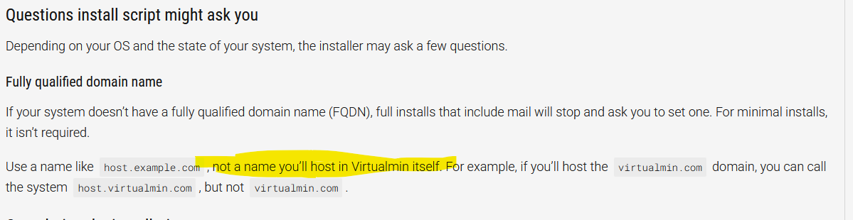

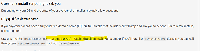

also you should NOT use a FQDN you will be using for hosting.
server.example.com would be fine.
