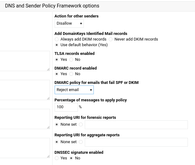

But, Virtualmin already handles DMARC. Click button.
I’m pretty sure I set this up because some company made it required. Setting it up isn’t hard. Managing was a pain in the axe to start. I think the initial setup is for ‘do nothing’ as a testing stage. Some places will reject that because they see it as a set and forget.
The reports aren’t human readable. Again, that was painful. But, if the initial setup is correct, you can forget about it. Basically, I think except for the damned ‘tuning features’ for testing, this wasn’t hard. (Not sure why you would tell someone to reject 80% of failures, but oh well… )
lol. It’s already there, that’s hilarious. We’ve been rambling on about it when all anyone needed to do was just look at it.
