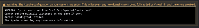

I have having issues with my Apache:
AH00526: Syntax error on line 3 of /etc/apache2/ports.conf:
Cannot define multiple Listeners on the same IP:port
Action ‘configtest’ failed.
The Apache error log may have more information.

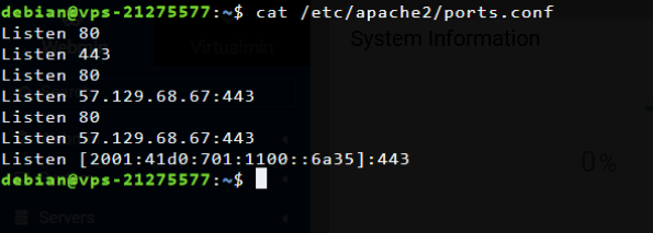

this is whats in /etc/apache2/ports.conf
Can you show contents of /etc/apache2/ports.conf before installing Virtualmin?
This is odd, I just did a clean install on Debian 12 and didn’t have this error.
Did you fix this, removing duplicate Listen lines I would think would help fix the issue.

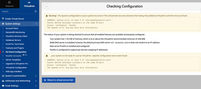

In the process of setup I got this error below:
Can you help me?
