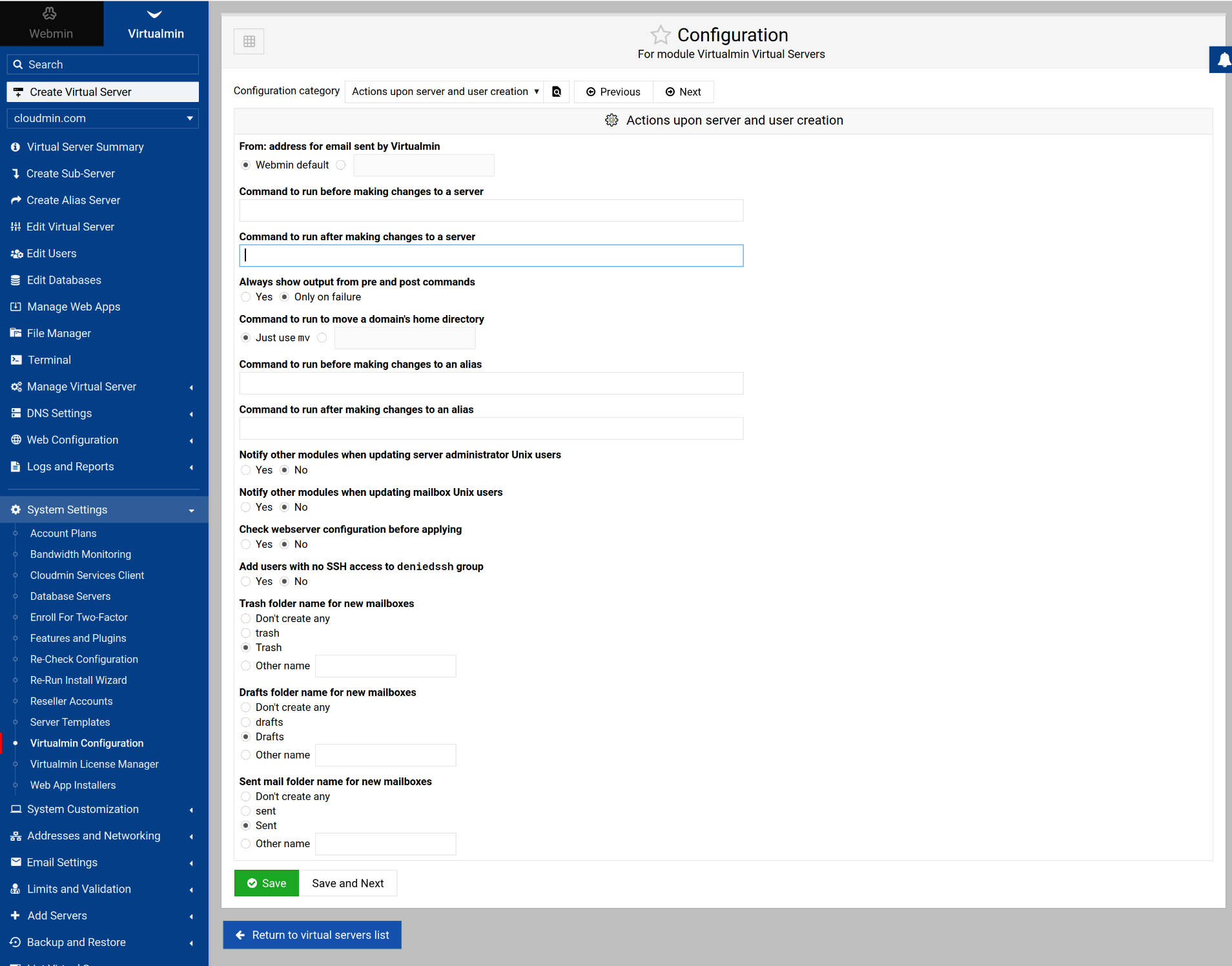

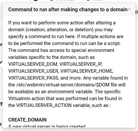

@Joe, no, I remember this being a puzzle back in time. I can’t remember how I solved it. I think I just combined all logs from all domains into one since I was the only user on the system.
Still, I’d prefer to keep them separate now and just automate adding and removing entries from the CSF config.
