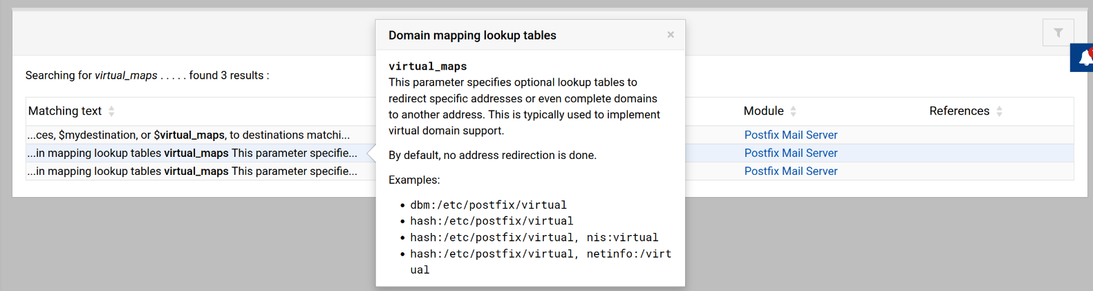

Postfix is one module (and this is rare, most modules don’t have this kind of help, though I wish they all did) that mentions which directive an option modifies in the tooltip help file. So, you can search for a Postfix directive by name, and see the help file which identifies which option in the UI modifies that directive.

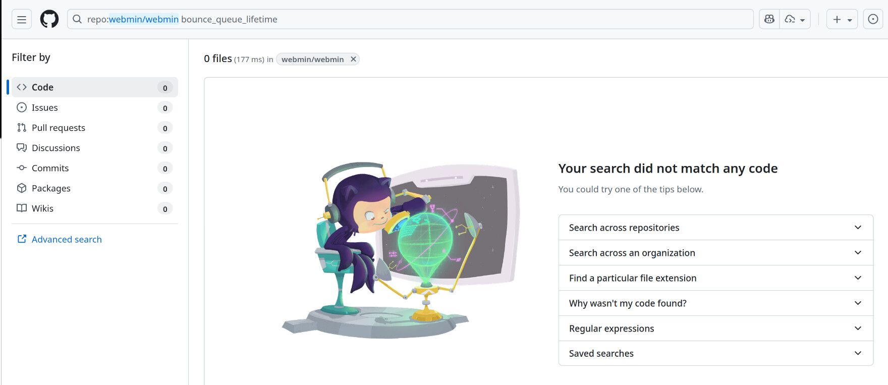

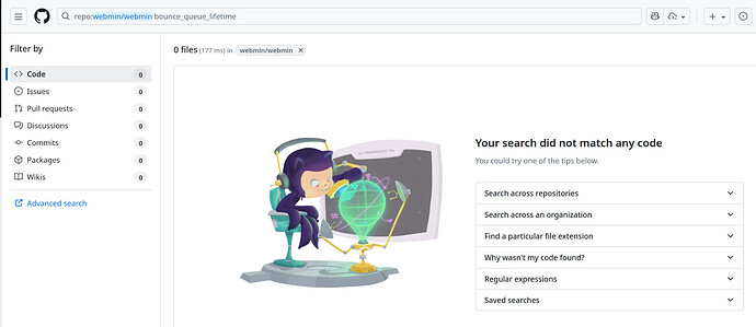

And, if you really want to be thorough and also search for options in modules other than Postfix, you can search the Webmin repo.
(But, I bet I can automate making sure searching knows how to search for an option by name from the configuration file, one way or another.)
