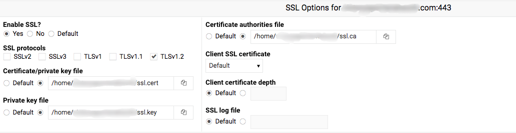

But everywhere I look in my server config, I have TLS 1.0 and 1.1 disabled. I have many sites on that server, not so many have SSL enabled, I’ve checked them all, and only TLS 1.2 is enabled.

Thanks for the answer. I use “config” generally, I pretty much looked everywhere in Webmin, and at the SSL Options page for the web sites I have set up on the server in Virtualmin. At first I assumed Amazon was referring to configuration that corresponds to this page in Virtualmin, at:
Apache is not talking to AWS. So, you’re looking in the wrong place.
