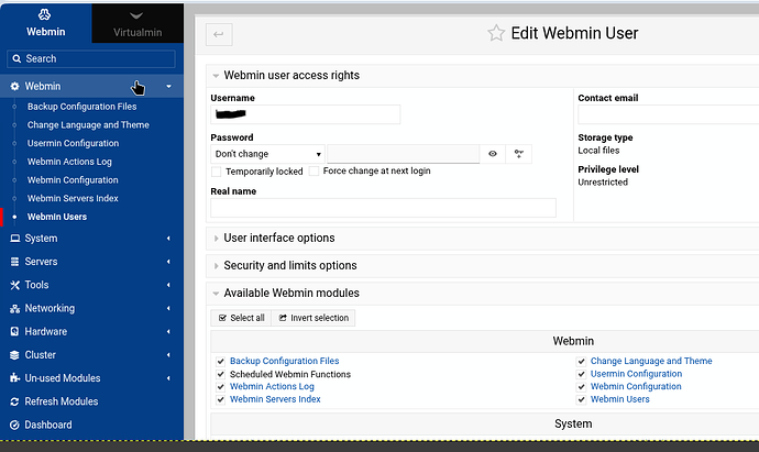

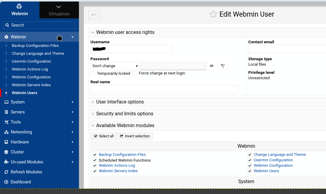

Webmin starts off with allowing root or admin. You then use the module to allow others. So, the user disallowed root. :frowning:
Webmin Users
March 14, 2023
· 19 min · Jamie Cameron |
Suggest Changes
About
A standard, out-of-the-box Webmin installation has only one user called root or admin, who can use every feature of every module
@AStaUK Can you edit the permissions?
